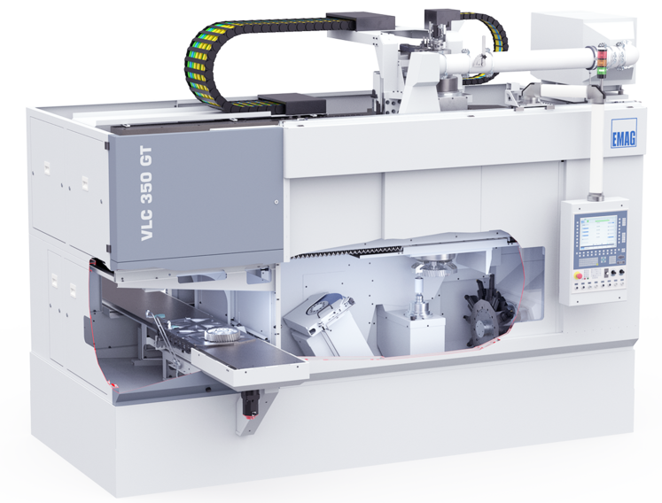

VLC 350 GT complete machining center with external grinding spindle, internal grinding spindle and turret for wave generator production in harmonic reducers
Vertical turning and grinding machine VLC 350 GT from EMAG for high-precision complete-machining of wave generators in harmonic reducers.

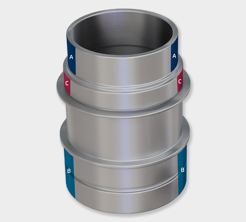

Elliptical external contours of a wave generator component
Wave generator profile with elliptical external contours. The shape deviation is in the µm range and requires high-precision grinding.
1. External grinding Reference A:
  • Grinding the O/D (Outer Diameter) 53 mm
  • Diameter check using a measuring probe
2. External grinding Reference B:
  • Grinding the O/D (Outer Diameter) 63 mm
  • Concentricity measurement for reference A
3. Ellipse grinding (C)
  • Final grinding of the ellipse contour with continuous NC interpolation
  • Symmetry check to the reference diameters A and B
