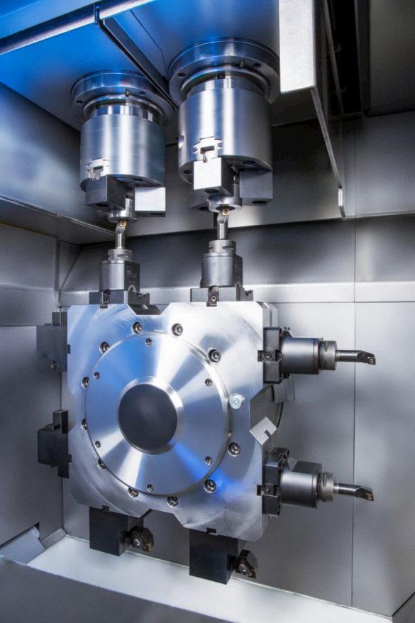

VL 1 TWIN Turning Center—Pick-Up Spindles
Two pick-up spindles are used to pick up both components from the feeding conveyor, transport them into the machining area and machine them simultaneously in the same clamping operation.
