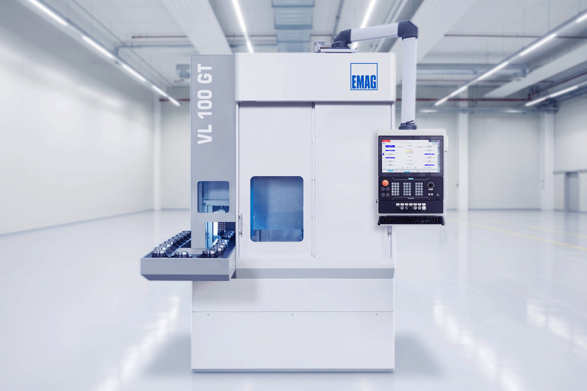

VL 100 GT for the precision machining of small chucked components using hard turning and grinding
The VL 100 GT combines hard turning and grinding in a compact vertical machine. The integrated pick-up automation helps minimize non-cutting times.

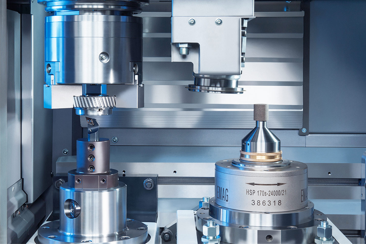

VL 100 GT performing hard turning and grinding in a single setup – work area with tools for finishing
Work area of the VL 100 GT with tool stations for hard turning and grinding. The combination of both processes enables precision machining without re-clamping.

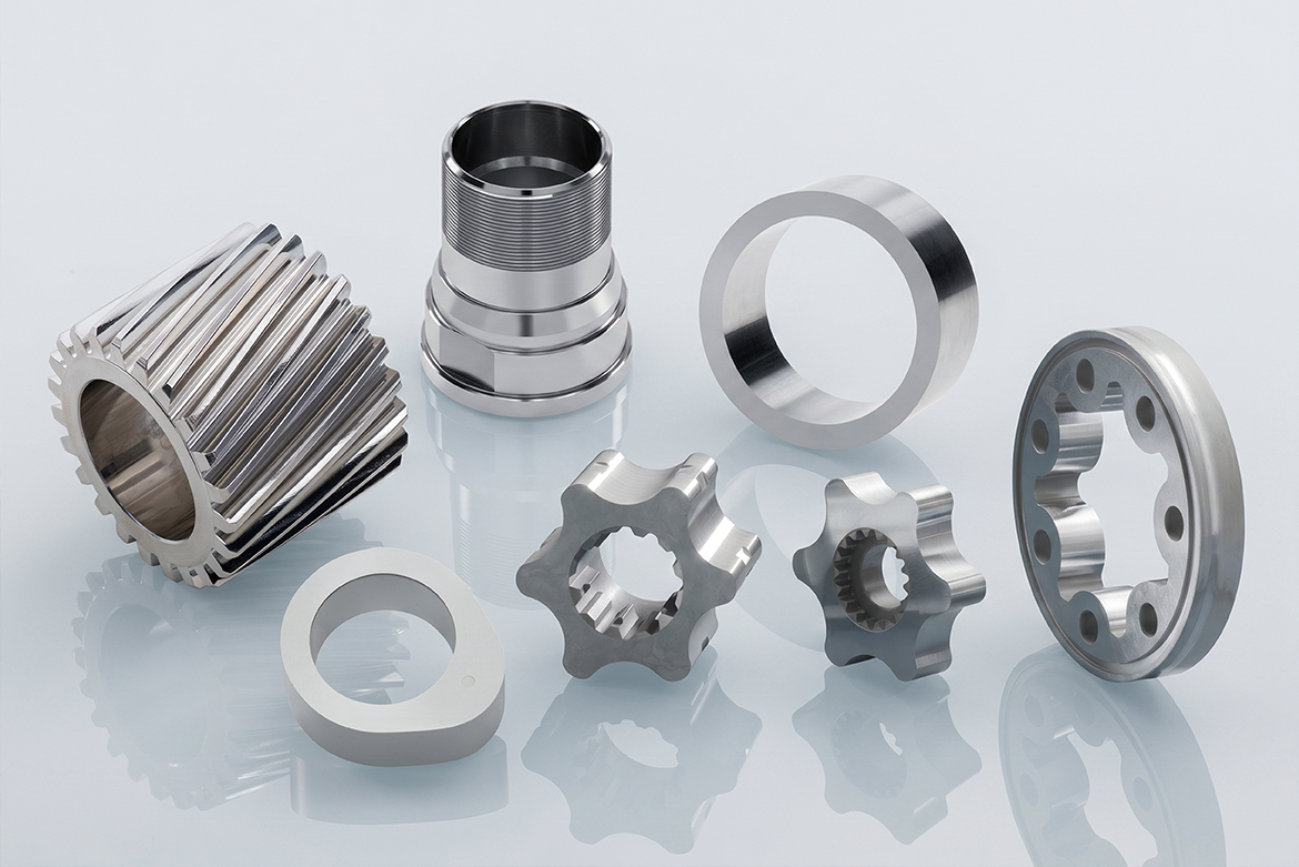

Typical workpieces for the VL 100 GT
The machine is designed for small- to large-volume production of hardened chucked components with workpiece dia. up to 100 millimeters. Typical workpieces include:
  • Gear wheels and planetary gears
  • Sprockets and sprocket carriers
  • Cam rings and cam discs
  • Pump rings and impellers
  • Individual cams and cam elements
  • Shaft generators for tension shaft gearboxes
All of these components require reliable precision machining after hardening, with high dimensional accuracy and a defined surface quality.
Typical chucked components for the VL 100 GT.
The VL 100 GT is suitable for the finishing of small chucked components such as planetary gears, cam rings, cam and pump components, and shaft generators.

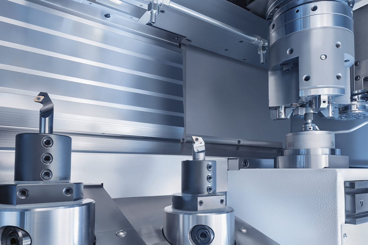

VL 100 GT for turning and grinding in a single setup – work area for the precision machining of chucked components
Work area of the VL 100 GT for combined turning and grinding operations. The machine enables the precision machining of small chucked components in a single setup.

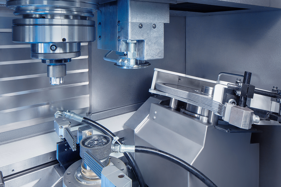

Precision machining of out-of-round contours
For out-of-round contours, the dynamics of the axes are crucial. The current generation of the VL 100 GT features a linear motor drive on the X-axis. This enables cam profiles, cam rings, cam discs, or eccentric surfaces to be machined with high precision.
The linear motor enables fast and precise movements without backlash. This significantly expands the range of workpieces that can be machined, particularly for components with complex functional contours.
VL 100 GT performing external grinding of Cams – work area for the fine machining of out-of-round contours
Work area of the VL 100 GT with an external grinding spindle for out-of-round cam geometries. This configuration supports precision contouring in fine machining.

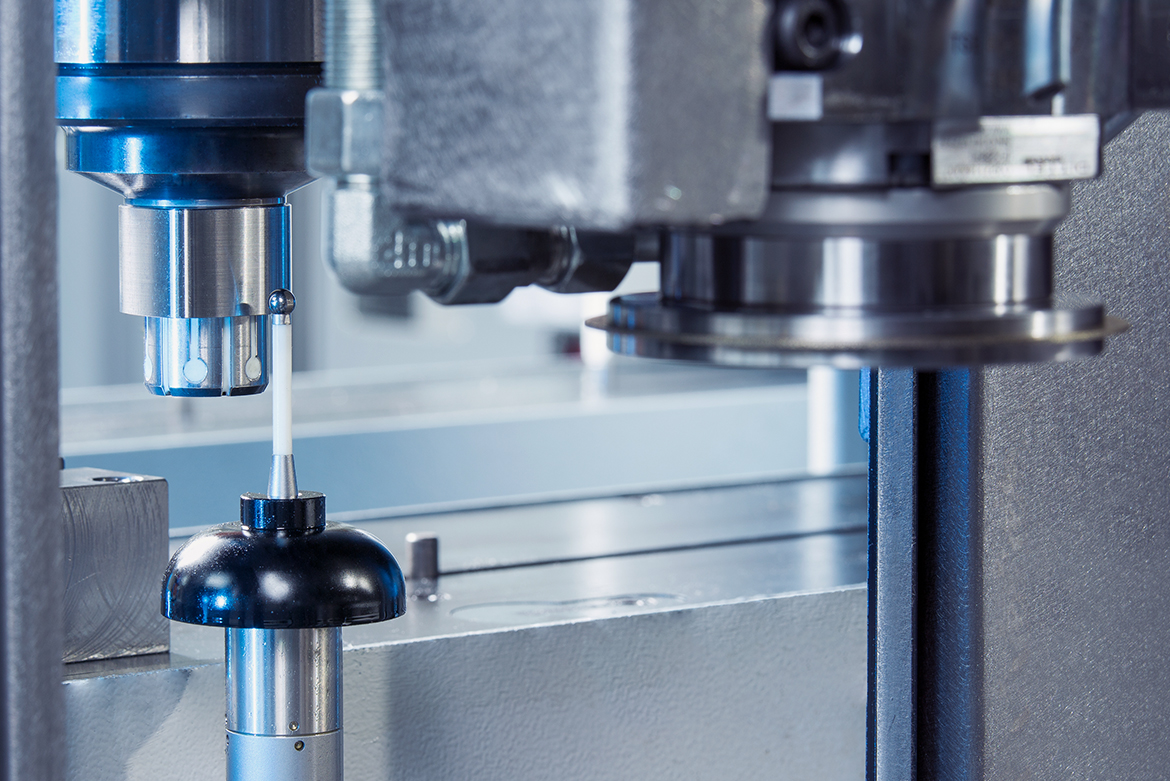

Process Monitoring and Integrated Measurement Technology
To ensure stable grinding processes, the VL 100 GT is equipped with grinding sensors and measurement technology. A structure-borne sound system supports contact detection between the grinding wheel and the workpiece, as well as between the dressing roller and the grinding wheel.
Adaptive process control can adjust the feed rate to the current machining conditions. The integrated measuring probe is located in a protected position between the work area and the pick-up station. Measurements are taken before, during, or after machining without having to unclamp the workpiece.
The VL 100 GT’s measuring probe checks the results of out-of-round grinding—quality control directly in the machine.
The integrated measuring probe checks the machining results directly in the VL 100 GT. This allows the quality of out-of-round geometries to be monitored without separate handling.
