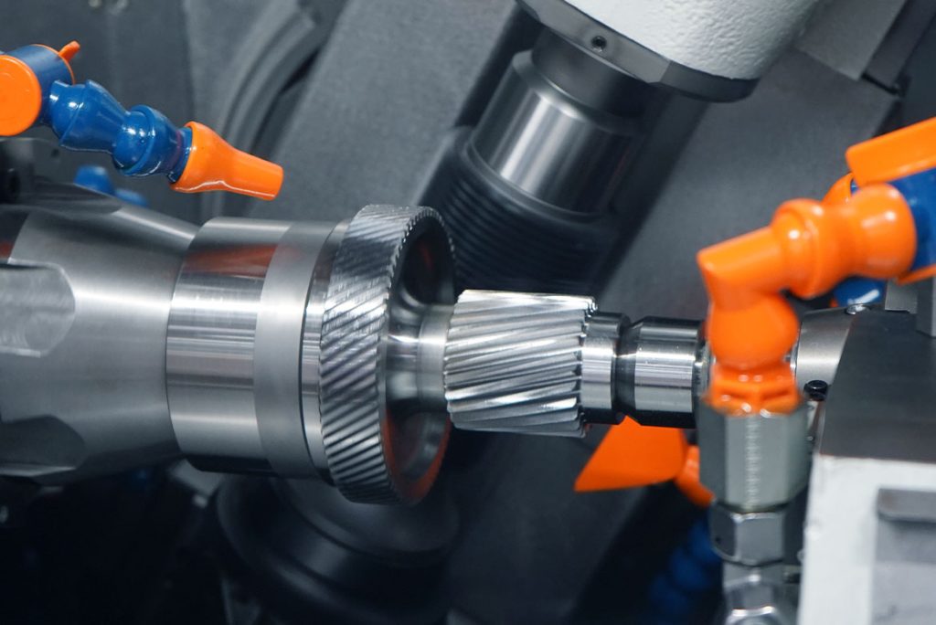

During power skiving, the smaller, collision-prone tooth profiles are machined using either an optional conical bell skiving wheel or a cylindrical gear skiving wheel. The tool continuously engages with the workpiece, generating the tooth profiles through a rolling cutting process. The key advantage of this process is that the skiving wheel only requires a minimal axial run-out, allowing it to be used even in areas with restricted installation space. Machining is performed in several cuts, with the tool gradually fed to the final geometry step by step.
Power skiving of a stepped planetary gear on an HLC 150 H
The skiving process enables the machining of tooth profiles close to the shoulder without axial run-out.
After power skiving has been completed, the milling head of the HLC 150 H (maximum swivel angle: 180 degrees) swivels for machining the external gearing. The larger external gearing is now machined by hobbing. A multi-start hobbing cutter is used here, which enables a significantly higher cutting volume per unit of time than power skiving. The helical gearing is produced using a double-cutting process, which guarantees a high surface finish with short machining times.
Swiveled milling head during hobbing of a tooth profile
After power skiving, the milling head swivels to hob the second tooth profile.

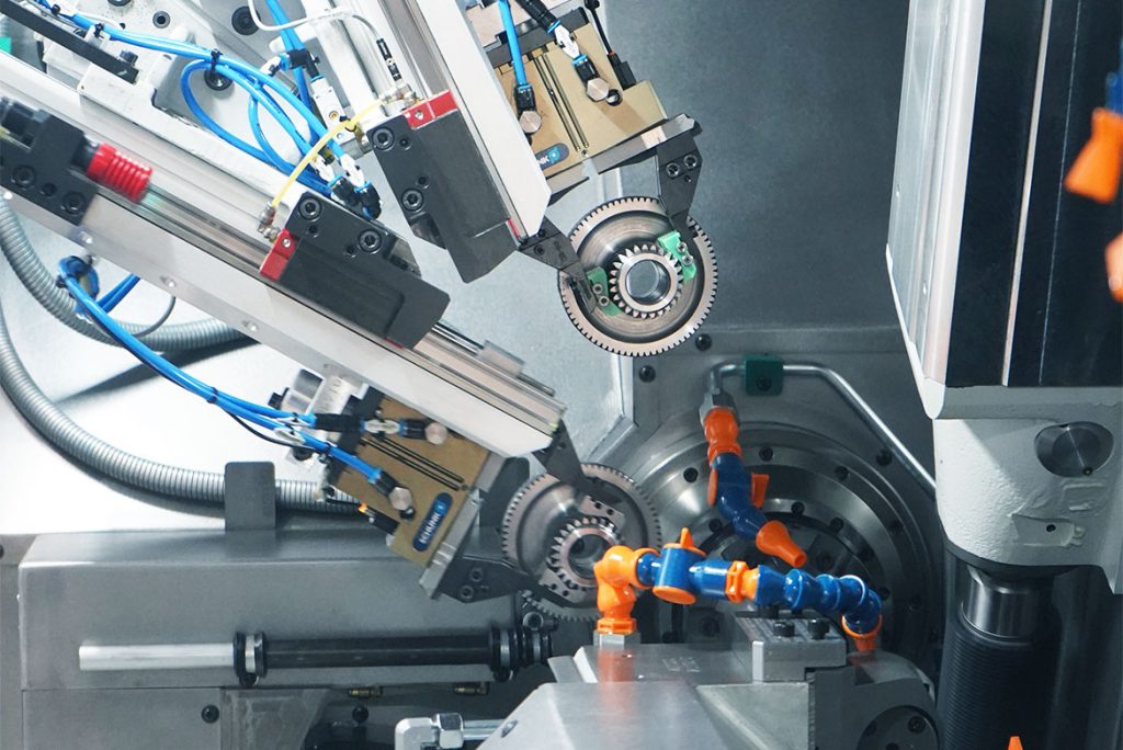

The HLC 150 H offers various automation solutions for batch production. With a gantry loader and linear gripper, workpieces up to 150 mm in diameter and 10 kg in weight can be handled. For smaller, lighter components weighing up to 2.5 kg, a faster loader with a double rotary gripper is available as an alternative, with which chip-to-chip times of less than five seconds can be achieved. Depending on the batches and production strategy, the automation can be scaled from simple manual loading via magazine systems to complete robot cell integration.
Gantry loader with gripper in the work area of the HLC 150 H gear cutting machine.
The automatic gantry loader with linear gripper handles workpieces up to 150 mm in diameter and 10 kg in weight.
