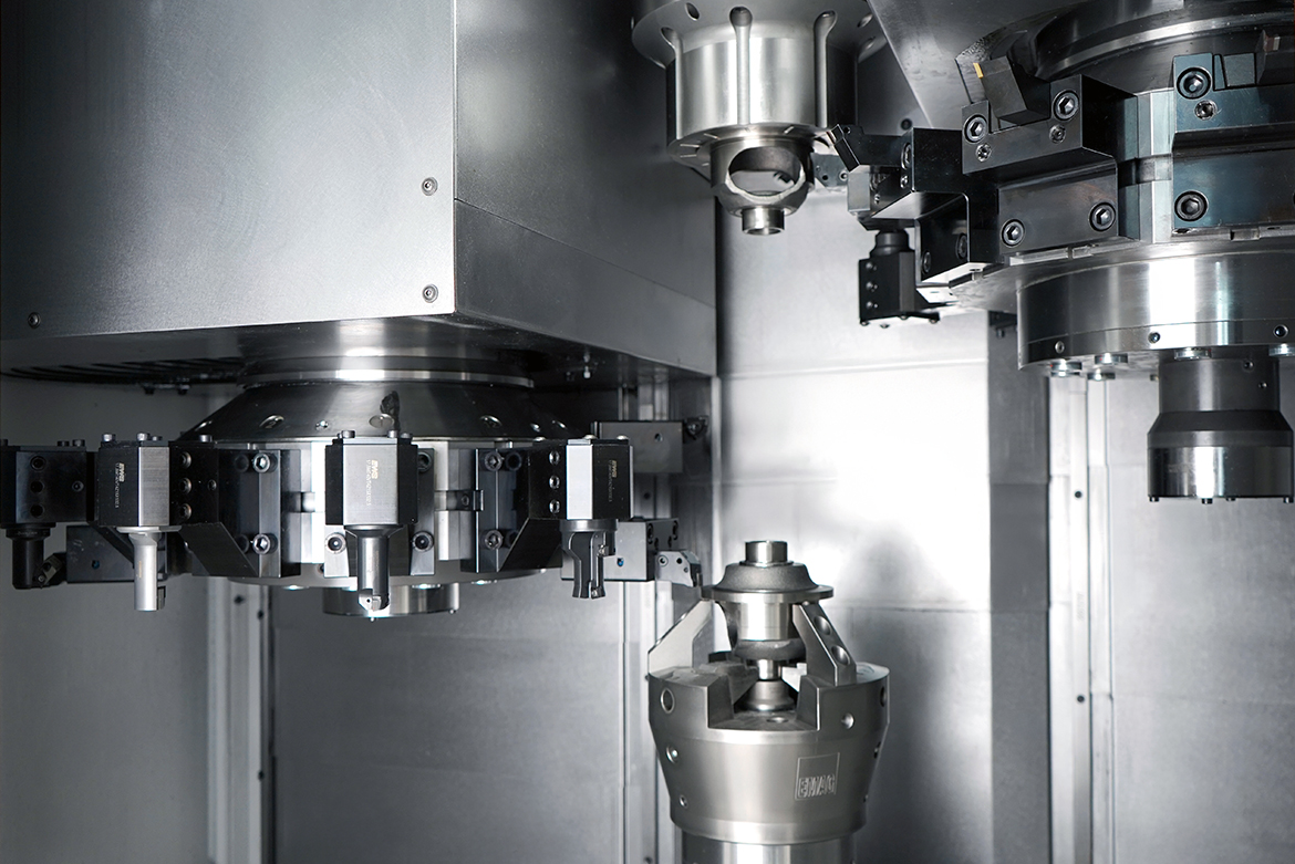

Work area of the VT 200 with two turrets and counter spindle for parallel machining and short cycle times.
View into the work area of the VT 200: Two opposing turrets enable simultaneous machining on both spindles. The compact design shortens the process sequence.

Right turret at the top, left turret at the bottom - simultaneous machining on two spindles in the VT 200.
The right-hand turret is machining the workpiece in the upper spindle, the left-hand turret is machining the workpiece in the lower spindle. Both work simultaneously and thus enable efficient complete-machining in the VT 200.

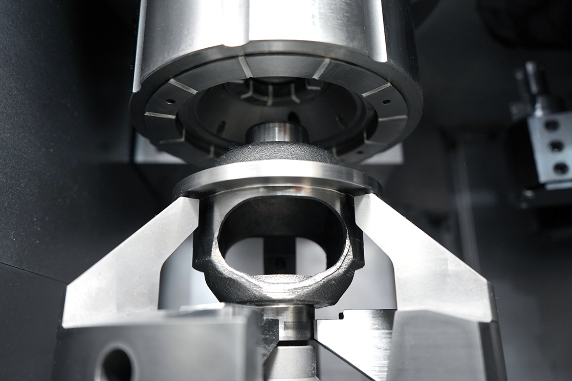

Workpiece transfer in the VT 200 between the lower and upper spindles for precise, tension-free complete-machining.
Transfer of the workpiece from the lower to the upper spindle.

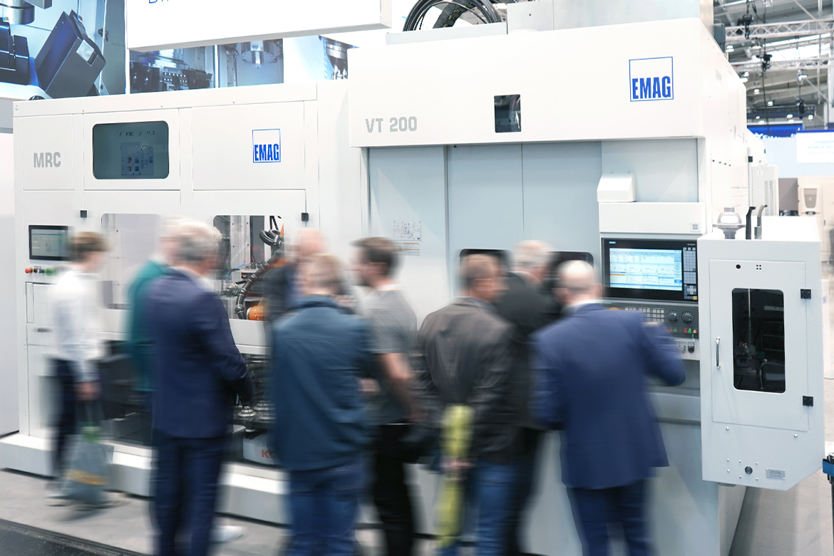

VT 200 lathe with MRC robot cell at EMO 2025 - compact manufacturing cell for automated machining.
The VT 200 with integrated MRC robot cell at EMO 2025. The combination shows how turning machine and automation merge into a compact, flexible manufacturing solution.
