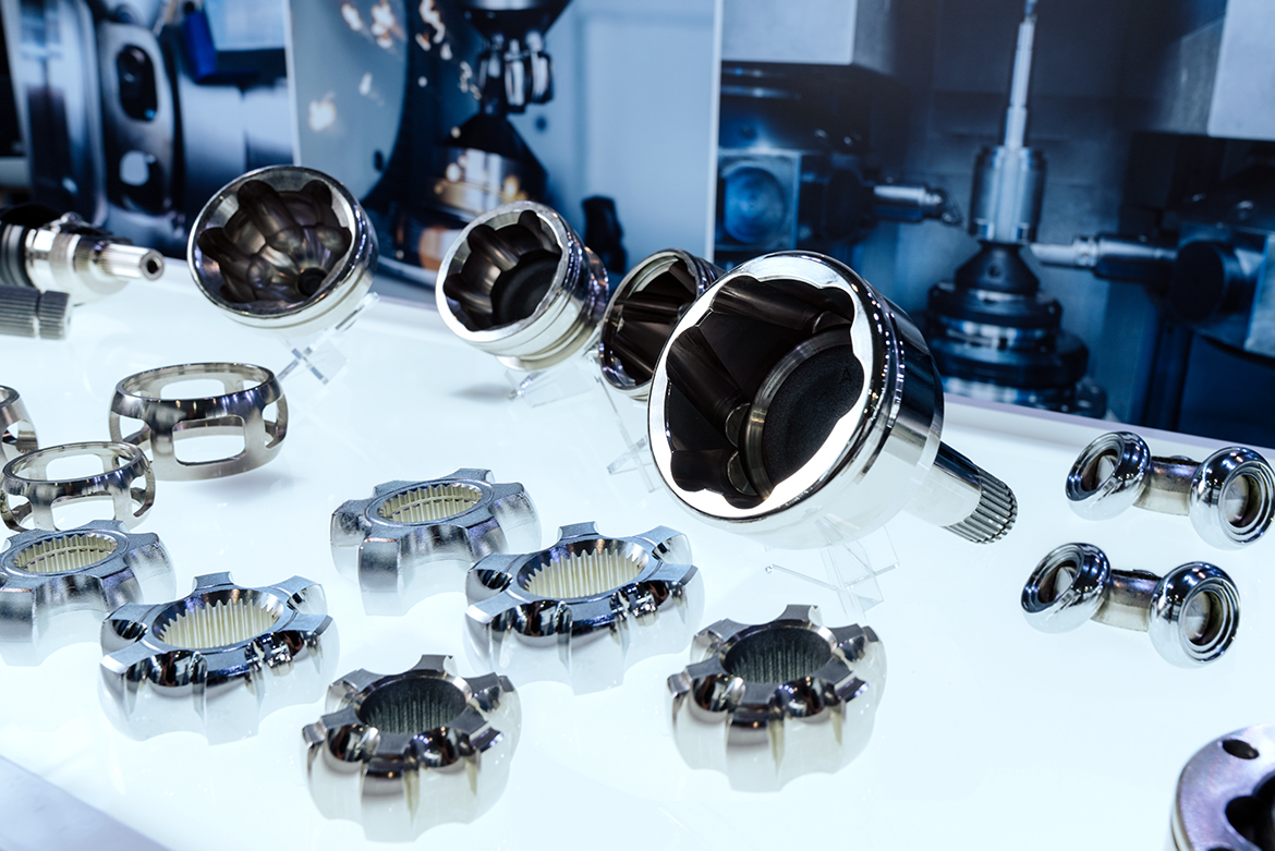

Manufacturing of ball tracks in joint housings: Precision machining with VSC technology
Joint housings as a central component in drive technology

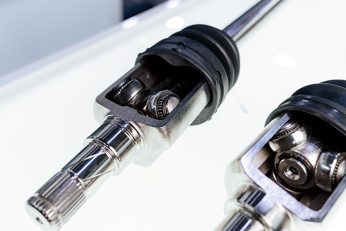

Cross-section model of a tripod joint with rollers and raceways for length compensation in the drivetrain
Cross-sectional model of a tripod joint with visible rollers and raceways. The design enables length compensation and torque transmission in the drivetrain.

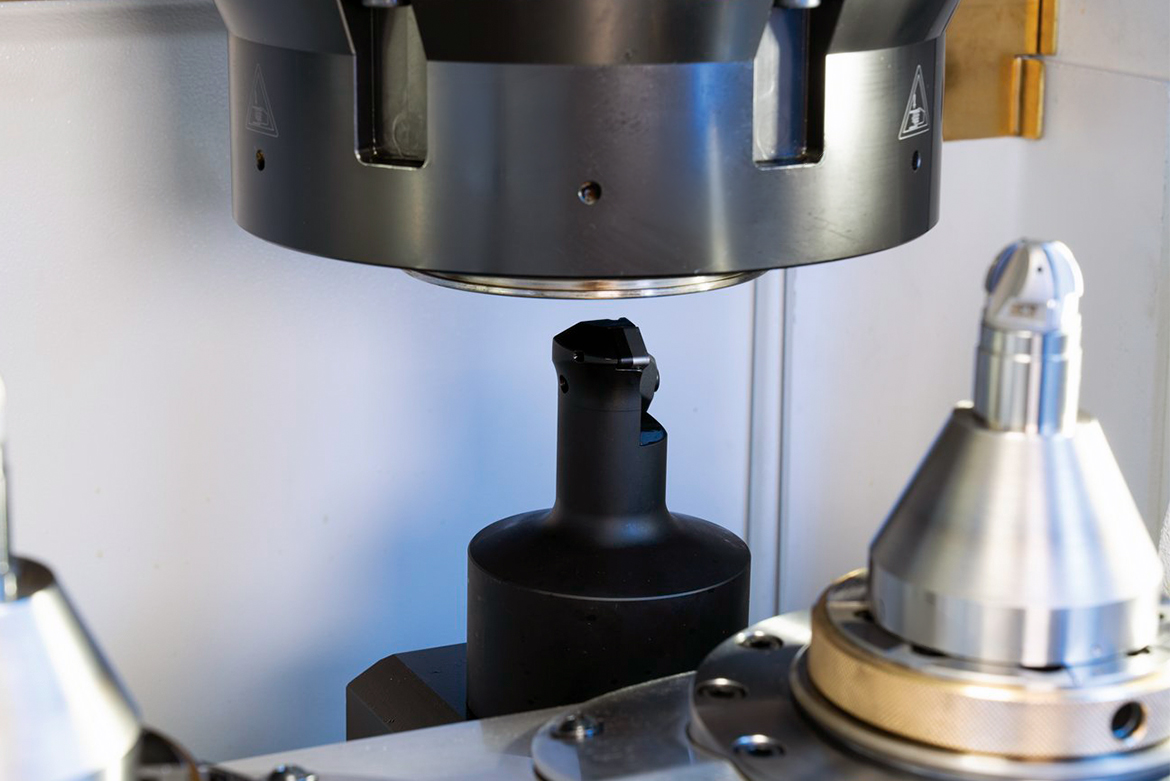

Soft turning of the internal geometry of a joint housing to prepare for subsequent ball raceway machining.
During soft turning, the internal geometry of the joint housing is machined with precision. This step establishes the positional and geometric foundations for the subsequent milling of the ball raceways.

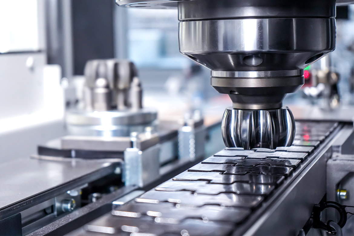

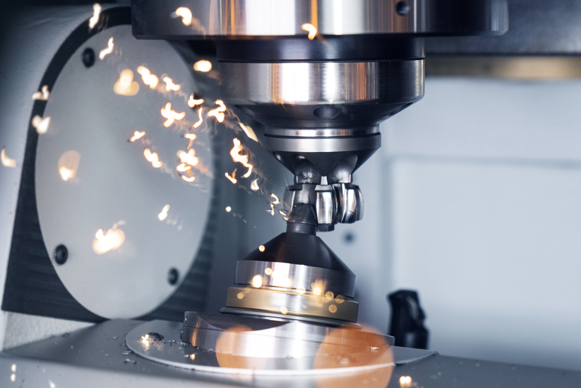

 4.2 Hard milling of the ball seats
After hard turning, the decisive machining step for the production of CV joints follows: hard milling of the ball tracks. In this final process, the actual functional geometry is created, which later enables power transmission between the drive shaft and axle while providing angular and longitudinal compensation. Requirements for this step are exceptionally high, as even minimal deviations in dimensional accuracy or surface finish can impair joint function.
Hard machining of hardened steels with surface hardnesses from 58 to 62 HRC represents one of the most demanding machining tasks. The hardened microstructure offers extremely high strength and wear resistance—properties desirable for joint function but challenging for machining.
In hard milling, material removal is very small—typically up to 0.2 mm. As a result, cutting forces are significantly lower than in soft machining, where material removal depths often reach several millimeters. Tool life is nevertheless limited, as even highly wear-resistant cutting materials such as cubic boron nitride (CBN) or ceramic materials are subject to continuous wear under high mechanical and thermal stresses. The thermal load on the cutting edge can reach temperatures exceeding 800 °C, leading to chemical wear.
Additional challenges arise from the surface zone structure of case-hardened components. Hardness decreases continuously from the surface maximum toward the softer core. This hardness gradient means the tool passes through areas of varying hardness during a single cut, resulting in fluctuating cutting forces. Additionally, residual austenite content in the surface zone can lead to unexpected machining behavior.
Hard milling of ball tracks with precision B-axis positioning and a stable spindle.
Hard milling produces the final ball raceways with high precision. The stable spindle and B-axis adjustment ensure consistent dimensional and positional accuracy.

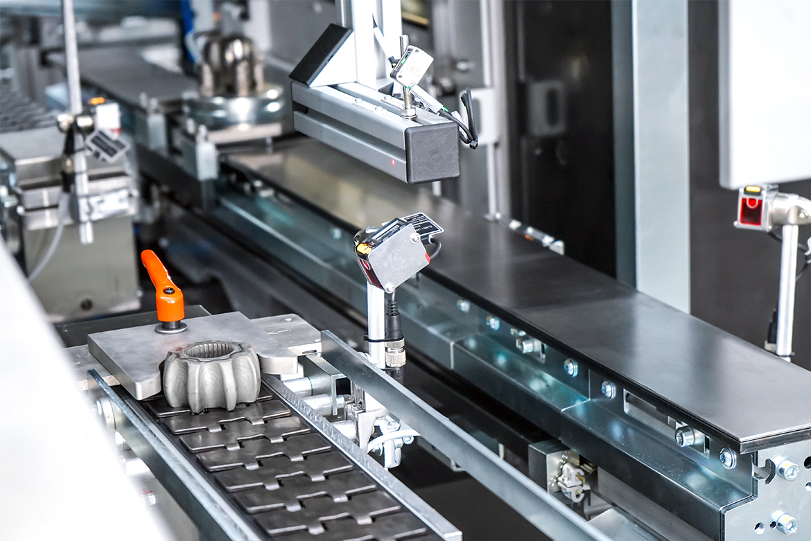

The machine is equipped with conveyor belts on both sides. The input-side belt handles raw-part feed and is designed as a storage section. Depending on the belt length, 20 to 50 raw-parts can typically be buffered here, achieving effective decoupling of upstream and downstream processes.
Automated parts feeding with sensory equipment and separation for reliable workpiece storage.
Automated feeding of workpieces for CV joint components. Sensory equipment, separation, and precision guidance ensure a reliable material flow in production.

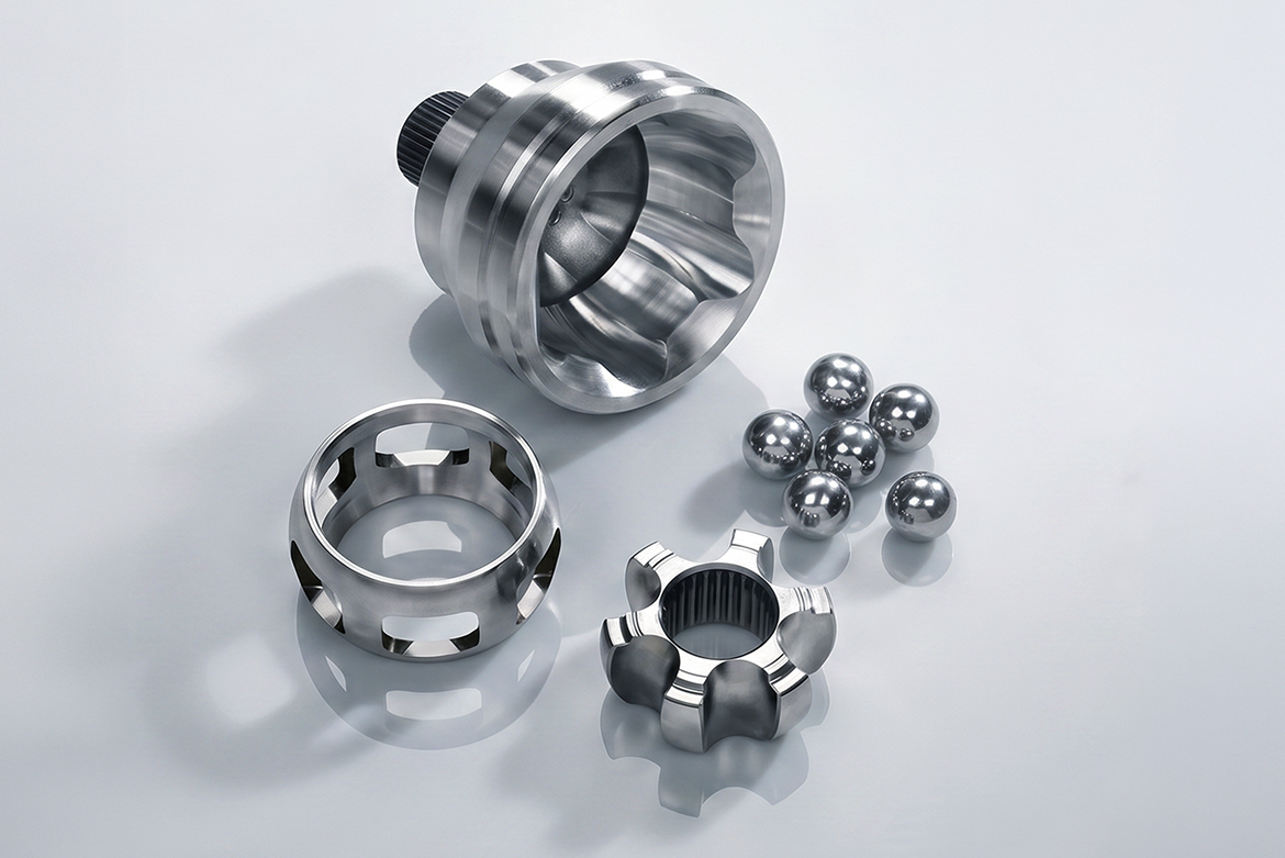

Joint housing, ball cage, inner race, and balls as components of a cv joint, machined with precision for maximum performance
Main components of a cv joint: joint housing, ball cage, inner race, and balls

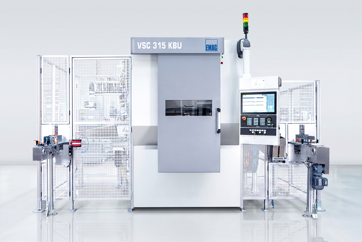

VSC 315 KBU: Single-spindle milling and turning center for joint housings
The VSC 315 KBU is a vertical single-spindle milling and turning center specifically designed for machining joint housings and inner races. The machine combines soft and hard machining in a single setup, enabling continuous production without re-clamping.
Machine concept and kinematics:
The main spindle is arranged vertically and holds the workpiece. Milling is performed by a milling spindle mounted on an NC swivel unit. The B-axis provides flexible tool orientation and allows a swivel range from -30° to +90°.
The machining of inclined ball tracks—particularly for VL joints—is, however, primarily carried out via the Y-axis. Straight ball tracks can be machined accordingly without the Y-axis.
The work area accommodates workpieces up to 160 mm in diameter and 280 mm in length. Axis travels: X-axis 935 mm, Y-axis 315 mm, Z-axis 315 mm.
