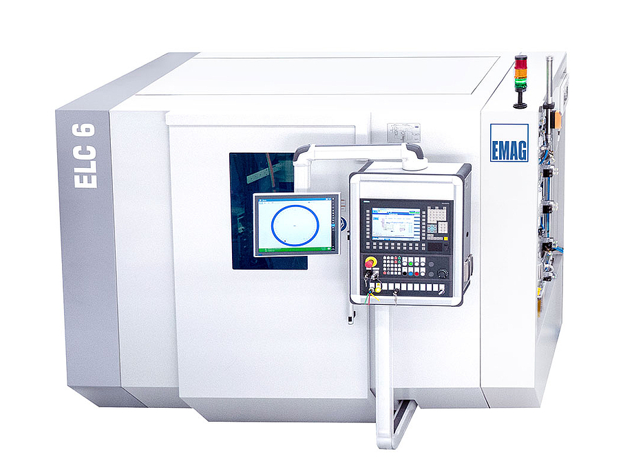

Laser Welding Machine ELC 6
The EMAG ELC 6 is a production laser welding system for maximum output and is ideal for classic powertrain components with round welds. The machine is based on a rotary indexing system with a machining station and a loading and unloading station.
Production Laser Welding System for Maximum Output
The main features of the ELC 6 are as follows:
  • Maximum operating safety thanks to the “Fixed lens/moving workpiece” principle
  • Rotary indexing system to achieve the best possible cycle time
  • Initial tension for welding up to max. 10 kN possible (30 kN available as an option)
  • Compact design and excellent accessibility
  • Short retooling times
  • Minimization of equipment and change parts
  • Low operating costs using high-effi ciency lasers and mainly electric drive units rather than pneumatics and hydraulics
  • High level of fl exibility in terms of technology, output, and automation
