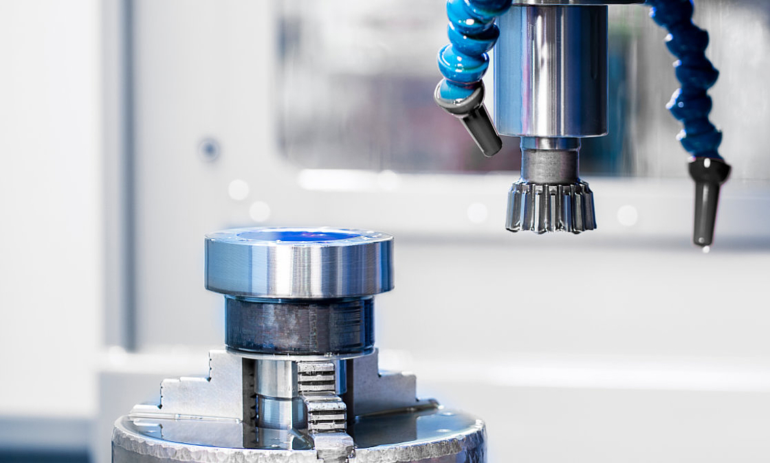

For those who want to produce gearing on workpieces with interfering contours – including a small overrun – gear shaping is frequently the only option. This method can also be used to produce grooves.
Highly productive gear shaping with tool changer
The method is a combination of two main motions: rolling and shaping. There are two processes in total:
- First, the gear is shaped radially (without a rolling motion) and in one position – this is called linear infeed. Only once this has been done does the rolling motion start and the other teeth are created.
- With helical infeed, on the other hand, all teeth are machined at the same time. The movement of the tool “into the depths” is therefore combined with the rolling motion. The first step here is a greater radial infeed, which is increasingly scaled back the deeper the tool penetrates the gearing.
Once the tool reaches the bottom of the gearing during the shaping step, it lifts up slightly off the workpiece. This prevents the cutting edges making contact with the newly formed gearing during the return stroke. This also reduces tool wear.
Overall, the process is very flexible, and can be used to produce spur and helical gearing with small overruns at the end of the gearing. The tools are cost-effective, and can be used for different numbers of teeth with the same module. The tool determines the profile shape. Flank line modifications are controlled via NC axes.
