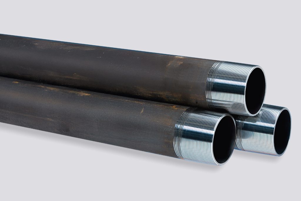

Close-up of tube ends with high-quality and precise thread profiles, produced on a USC 21
Tube ends with precision machined threaded connections – ideal for API, GOST integral and premium threads

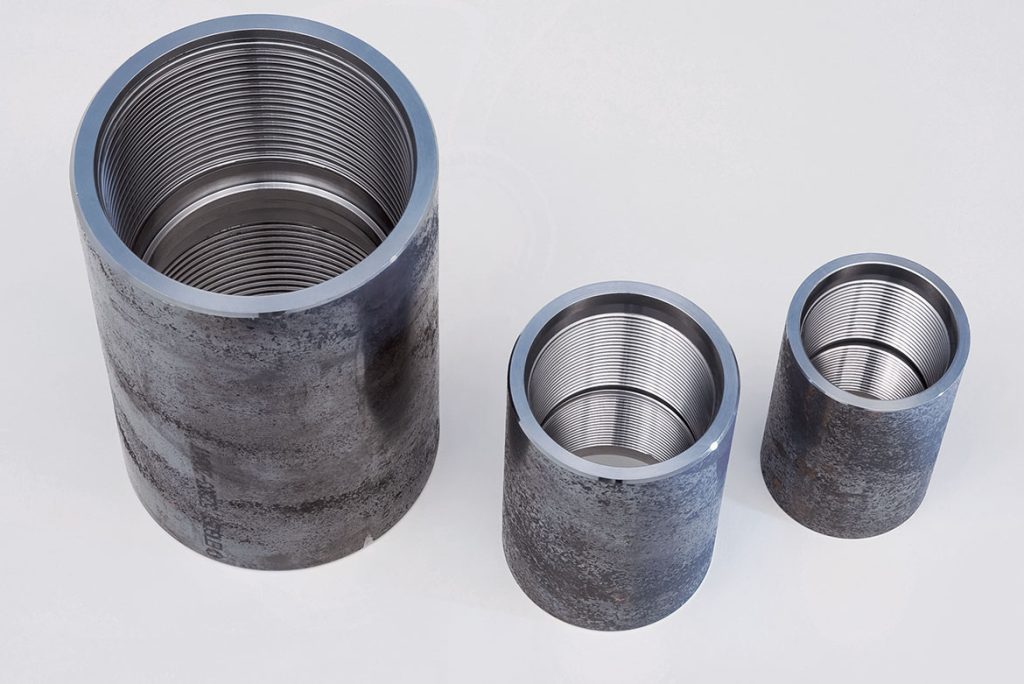

Close-up of finished machined couplings with clean and precise thread profiles, produced on the VSC 450 and VSC 500 lathes
OCTG couplings with high-precision threaded connections, manufactured on EMAG VSC vertical turning machines

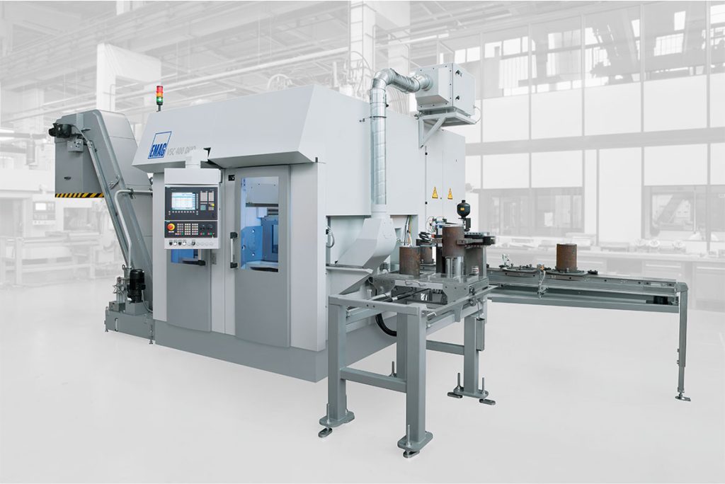

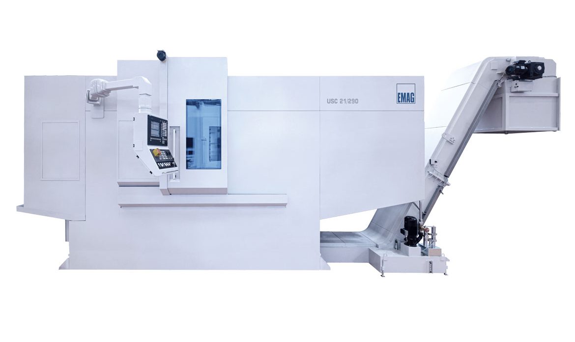

Front view of the EMAG USC 21 / 290, clearly showing the control panel, work area access and robust machine construction.
Front view of the EMAG USC 21 / 290, the modular solution for flexible and precision pipe end machining

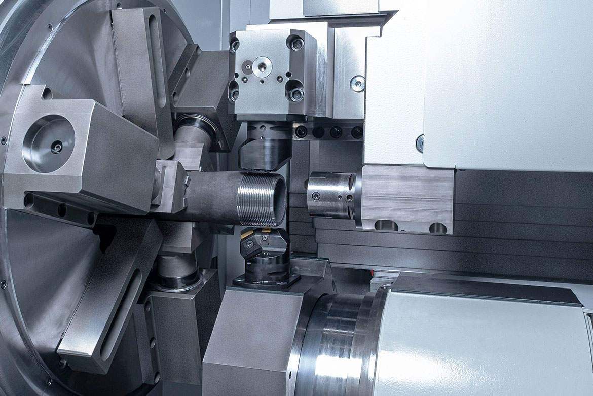

Close-up of the work area of an EMAG USC 21: Two turrets (positioned at the top and bottom) simultaneously machining a tube ends.
Two USC 21 turrets enable parallel processing steps and significantly reduce cycle times.

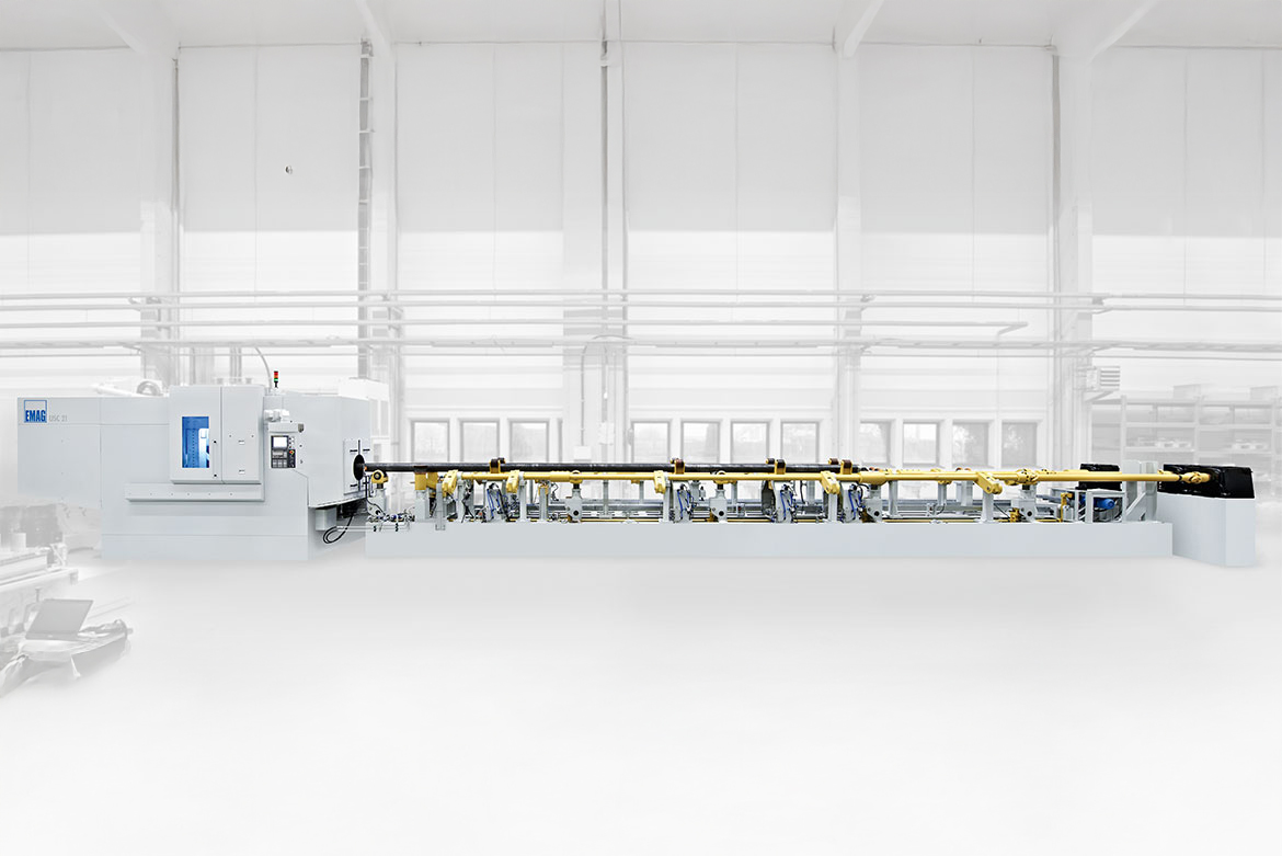

Complete view of an EMAG USC 21 machine including automatic pipe feeding system, which enables seamless feeding of the machine.
EMAG USC 21 with integrated automatic tube feed for smooth production processes
