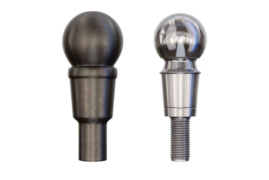

Blank and finished turned ball pin in comparison - unmachined on the left, precision machining on the right.
On the left an unmachined blank, on the right a finished turned ball pin with. The component on the right shows the precision contour and smoothing of the ball.

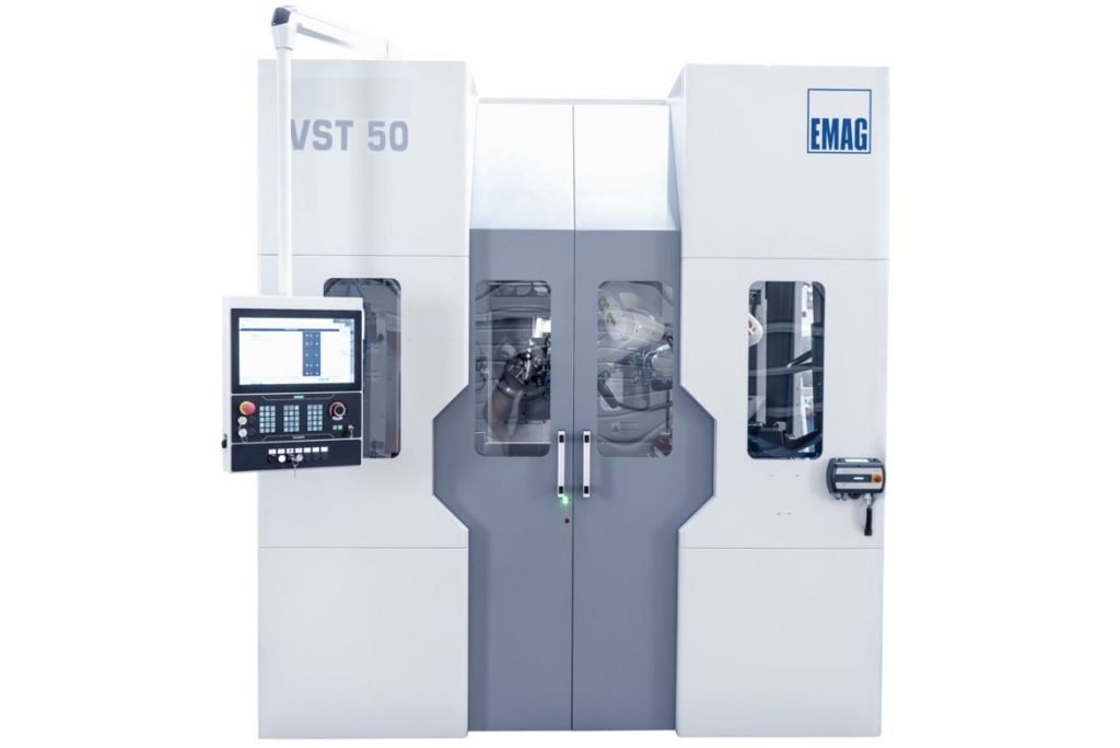

The VST 50 from EMAG - compact CNC turning machine for precision ball turning with automation.
The VST 50 turning machine from EMAG is designed for high-precision ball turning in series production.
Key features at a glance:
  • Two workpiece spindles enable parallel loading, unloading and turning – one spindle is machining while the other is loading.
  • Rotative B-axis for precision ball machining, including smoothing process.
  • Linear U-axis for setting the ball diameter and shape (polarity).
  • Integrated process measurement technology using a light-band micrometer for 100% inspection of each component.
  • Automated loading and unloading with three robots, optimized for the shortest cycle times.
  • Tool change during operation, supported by RFID-coded tools and robot handling.

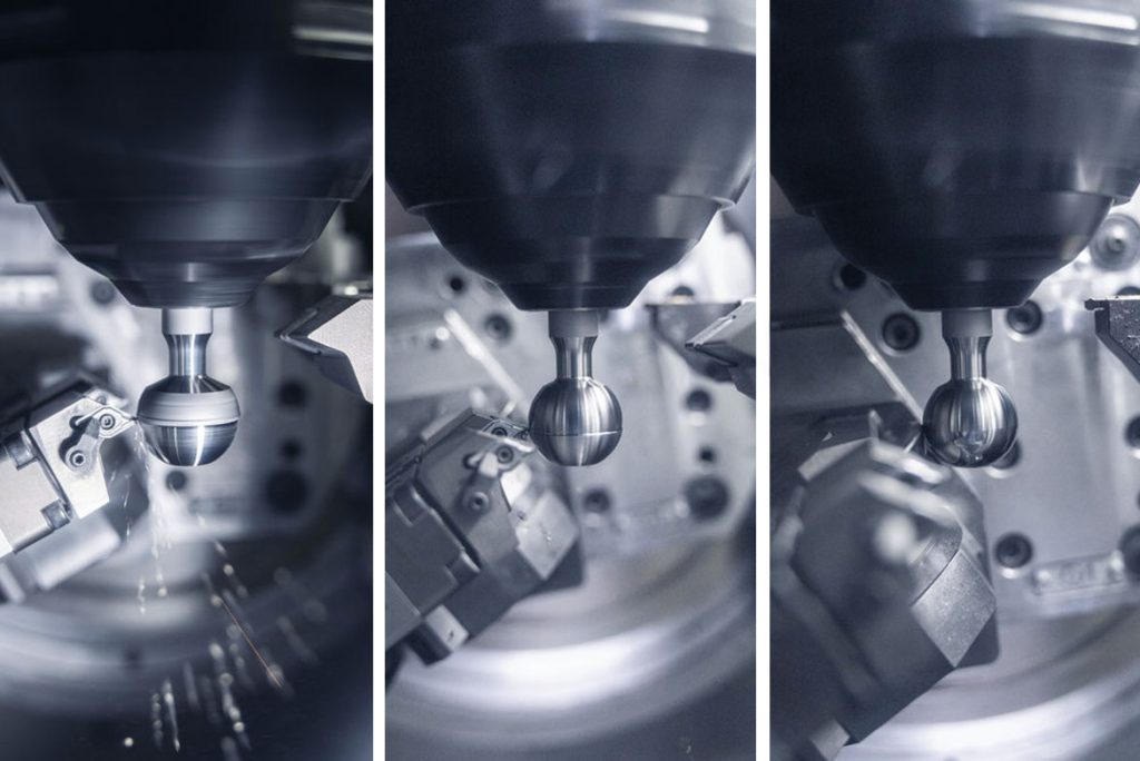

Precision ball machining in the VST 50 with rotating B-axis and finely tuned tools.
The work area of the VST 50 shows the precision turning of a ball pin. The rotary B-axis allows the ball to be shaped precisely. The tool and component are optimally coordinated to achieve the highest surface finish.

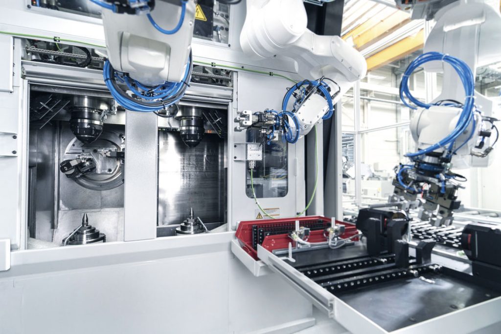

Three robots load the VST 50 fully automatically - for short cycle times and reliable production processes.
Three cooperating robots ensure a fast and precise material flow in the VST 50. They take over the loading and unloading of the spindles as well as the transfer to external automation modules. The system is designed for maximum cycle times and process reliability.
