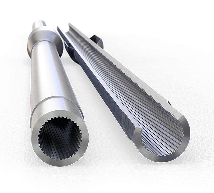

Gun barrel with visible rifling profiles, partially cut open to reveal the precise interior contour.
Illustration of a gun barrel with precisely manufactured rifling profiles – cut open to reveal the uniform contour of the interior machining.

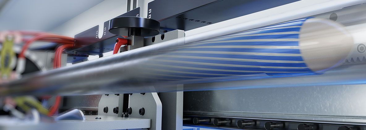

Cathode during rifling of a gun barrel with the PO 3000 IP ECM machine
Illustration of the electrochemical rifling process in the PO 3000 IP: The guided cathode generates precise tension-field profiles in the gun barrel.
