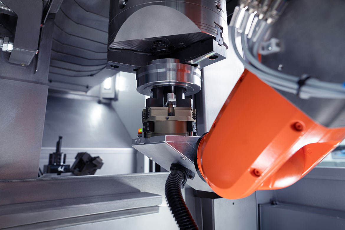

Robot loads EMAG vertical turning machine directly.
An industrial robot precisely inserts a workpiece into the spindle of an EMAG vertical turning machine.

Basically, the workpieces have to fit on the machine, of course. A key feature is that they must have a hole. This is crucial for picking up and positioning by the robot.  As far as tolerances are concerned, we are quite flexible. Even turned-out jaws are not a problem. This is due to the high positioning accuracy of our robot. We have developed a sophisticated system in which the robot uses a spring assembly to press against. This combination of precision robot control and mechanical fine adjustment enables us to work reliably even with workpieces with tight tolerances.

The advantages of direct robot loading over classic pick-up loading are manifold. Firstly – and this is the main advantage – we save cycle time. With the traditional method, we have an additional step: the workpiece is first placed on an intermediate station (conveyor belt) and transported from there into the machine. With our process, this intermediate step is completely eliminated. The robot inserts the workpiece directly into the spindle. This not only saves time, but also reduces potential sources of error. Secondly, this method offers us more flexibility in the process sequence. For example, we can blow off the chuck directly on site. This allows us to handle the workpieces even more efficiently. Another important advantage is the possibility of immediate reworking. The components remain clamped in the robot gripper, so that we can clean, mark or measure them immediately. This optimizes the entire production process and increases the quality of the end product.
