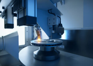

5. What does all this mean for production?
Coating brake discs to reduce wear is not a new idea. However, there have been a number of problems to date – from high production costs and complex preparatory work to disruptive coating thicknesses. In this context, EMAG offers a new additive process in cooperation with HPL Technologies. In this process, material powder is specifically transported into the focus of a laser beam, where it melts while still in the air and hits the surface of the brake disc, which is also melted.
Hard coating of brake discs
In cooperation with HPL Technologies, EMAG offers a new additive process for coating brake discs.
