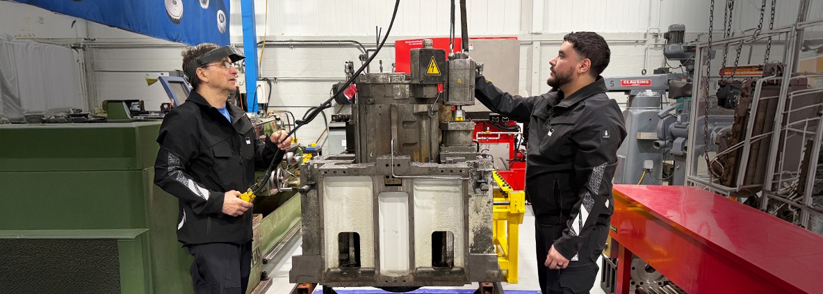

Our spindle repair department, established in September 2025, is staffed by factory-trained and certified technicians focused on precision repair and rebuild work. Capabilities include:
- Complete headstock repair & rebuild
- Main spindles
- Feed drive assemblies
- Live tools
- Scales and measurement systems
Each spindle is evaluated, repaired, or rebuilt using documented procedures and precision inspection methods to ensure reliable return to operation.
