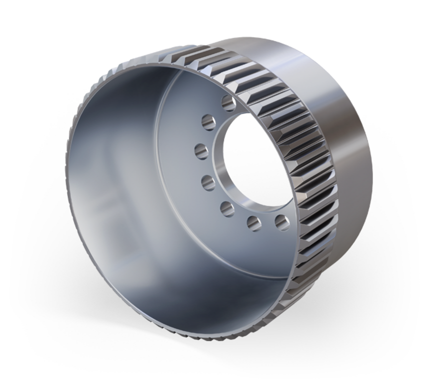

Flexsplines typically have wall thicknesses of less than one millimeter. This thin-walled design is functionally necessary but poses significant challenges for workpiece clamping. Even slight clamping forces can lead to elastic deformation, which directly results in gear-cutting errors. Typical module sizes range from 0.15 to 1.5 mm with a number of teeth between 100 and 400. High-strength steels such as SNCM 439 (40CrNiMo) are used as the material, which achieve hardness values of 38 to 42 HRC after heat treatment.
Steel flexspline with fine external teeth on the upper edge, cylindrical thin-walled design for harmonic reducers
Thin-walled flexspline made of high-strength steel with external teeth. The cylindrical design allows for elastic deformation within harmonic reducers. Typical workpiece dia. ranges from 25 to 140 mm.

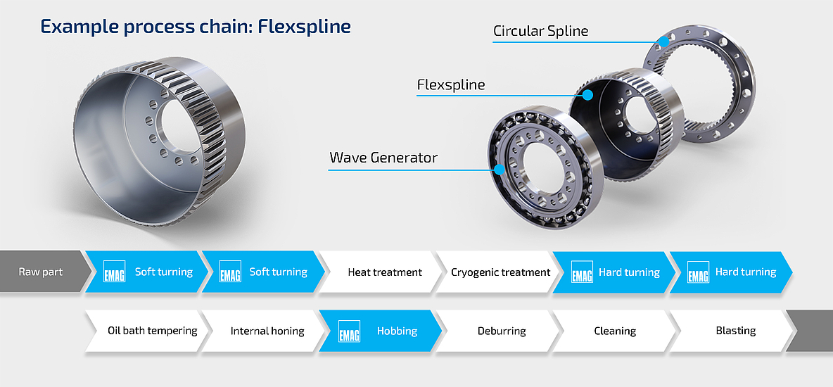

Process chain for flexspline manufacturing
Flexsplines are manufactured in a multi-step process chain that includes both soft and hard machining. Each process step must be coordinated with precision to achieve the required final qualities.
1. Soft turning: Rough machining of the blank geometry, finishing of the contours prior to heat treatment
2. Heat treatment: Hardening and high-temperature tempering,  cryogenic treatment with liquid nitrogen followed by low-temperature tempering
3. Hard turning: Precision machining after heat treatment; finishing of functional surfaces
4. Oil bath tempering: Thermal stabilization and stress relief
5. Internal honing: High-precision finishing of the internal bore as a reference for gear cutting
6. Hobbing: Gear cutting
7. Deburring:  Removal of machining burrs from the tooth edges
8. Cleaning: Industrial parts cleaning
Process diagram showing Flexspline manufacturing: soft turning, hardening, deep freezing, hard turning, honing, gear hobbing, deburring, cleaning, blasting
Complete production process chain for Flexsplines from EMAG. Twelve steps from blank to finished component

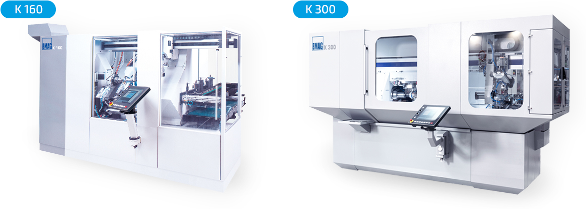

EMAG Machine Portfolio for Flexspline Machining
With the K Series, EMAG offers two machine platforms that are specifically optimized for machining harmonic reducer components. Both machines feature the high-precision package described above and differ primarily in their capacity.
EMAG K 160 and K 300 gear hobbing machines for Flexspline production
K 160 (left) and K 300 (right) gear hobbing machines for Flexspline machining. Cast iron machine base and water-cooled direct drives for maximum precision
K 160 – Compact solution for small modules
The K 160 is ideal for Flexsplines with small modules. The open design offers good accessibility while maintaining a compact footprint. The machine is suitable for workpieces with an O/D (Outer Diameter) of up to approximately 100 mm.
K 300 – Highly rigid solution for larger workpieces
The K 300 features a closed machine frame that ensures maximum rigidity even under high machining forces. This design is particularly suitable for larger flexsplines with an O/D of up to 140 mm. The closed-loop framework construction, in which a yoke connects the main spindle side and the tailstock side, prevents deformation of the machine even under high clamping forces.
