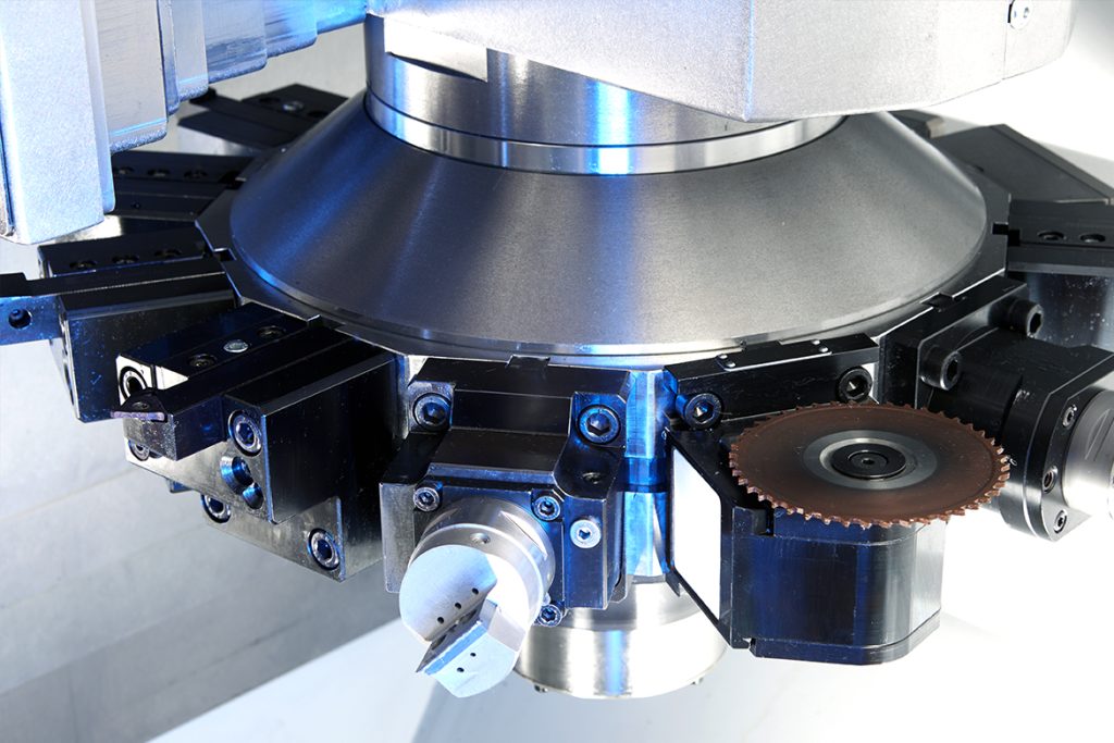

Turret VL machine
Turret in a VL machine from EMAG: Driven tools (such as the golden drill) and non-driven tools (the cutting plate in the foreground) can be easily distinguished.
