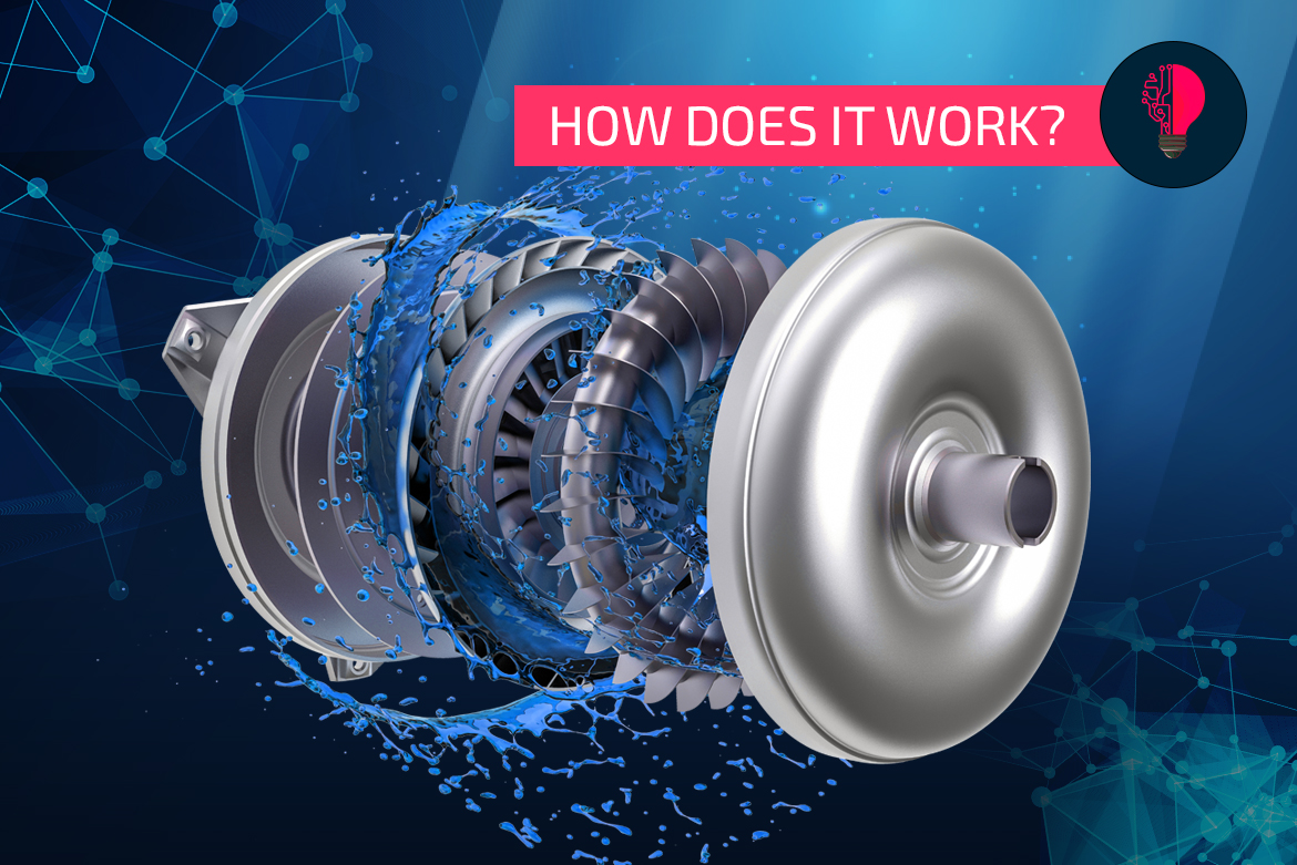

“Classic” automatic transmissions are usually based on torque converter technology – it is therefore something like the traditional standard in this area. The whole thing owes its name to the torque converter. This is a construction consisting of a guide wheel, turbine wheel and impellers, which are located in a housing filled with oil and act as a kind of intelligent clutch – in other words, as a connection between the drive and the actual transmission.
A hydrodynamic process takes place inside it: the impeller is connected to the motor and turns at the corresponding motor speeds. This moves the oil in the housing and generates flow energy, which in turn is transferred to the opposite turbine wheel. You could also say that the oil pressure provides the power transmission to the turbine wheel. When it turns, the downstream transmission also moves and, thus, the car.
There is also a guide wheel inside the torque converter, although it does not turn and its task is to increase the torque on the blades of the turbine wheel by redirecting the oil flow. It also directs the oil flow back to the impeller blades.
Torque converter
Exploded view of a torque converter: The oil pressure ensures power transmission.
