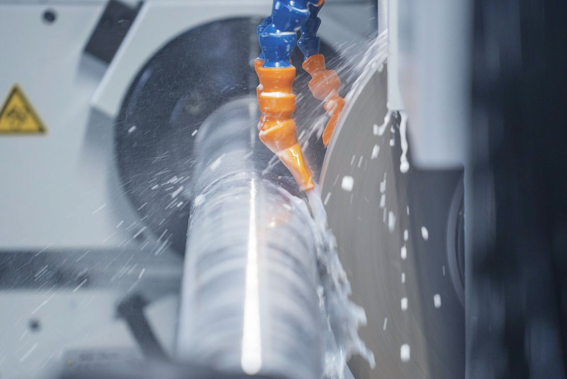

Front view of the W 11-EVO cylindrical grinding machine in the work area.
Thanks to its open design, the W 11-EVO offers the operator an optimal view of the sanding process. The ergonomic arrangement of the operating elements enables direct intervention when machining valuable individual pieces.
