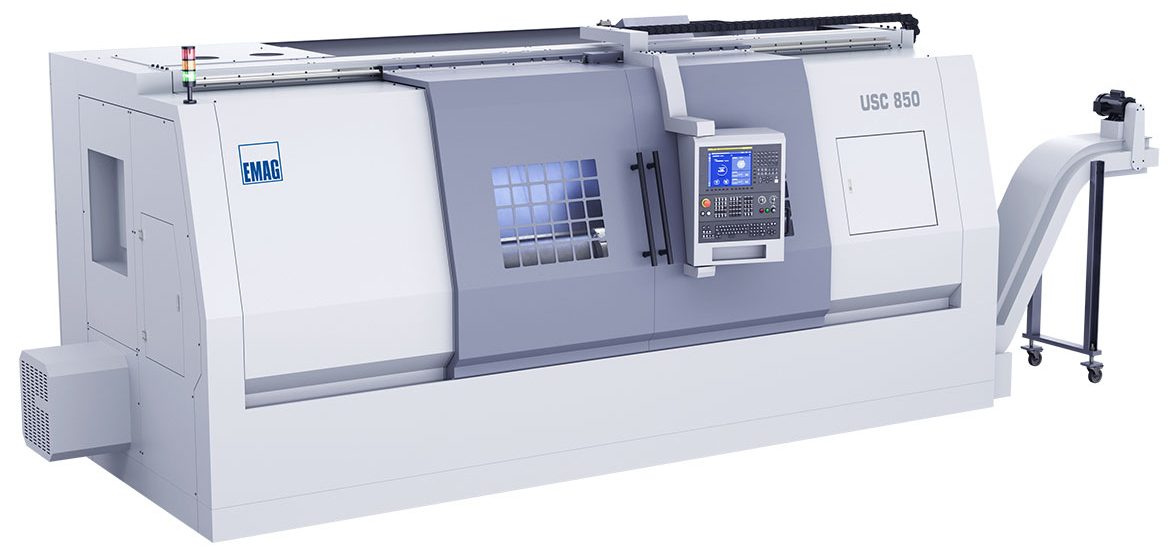

Exterior view of the USC 850, equipped with modern CNC control.
Exterior view of the USC 850 universal lathe with closed housing, CNC control panel and stable machine structure for demanding machining tasks.

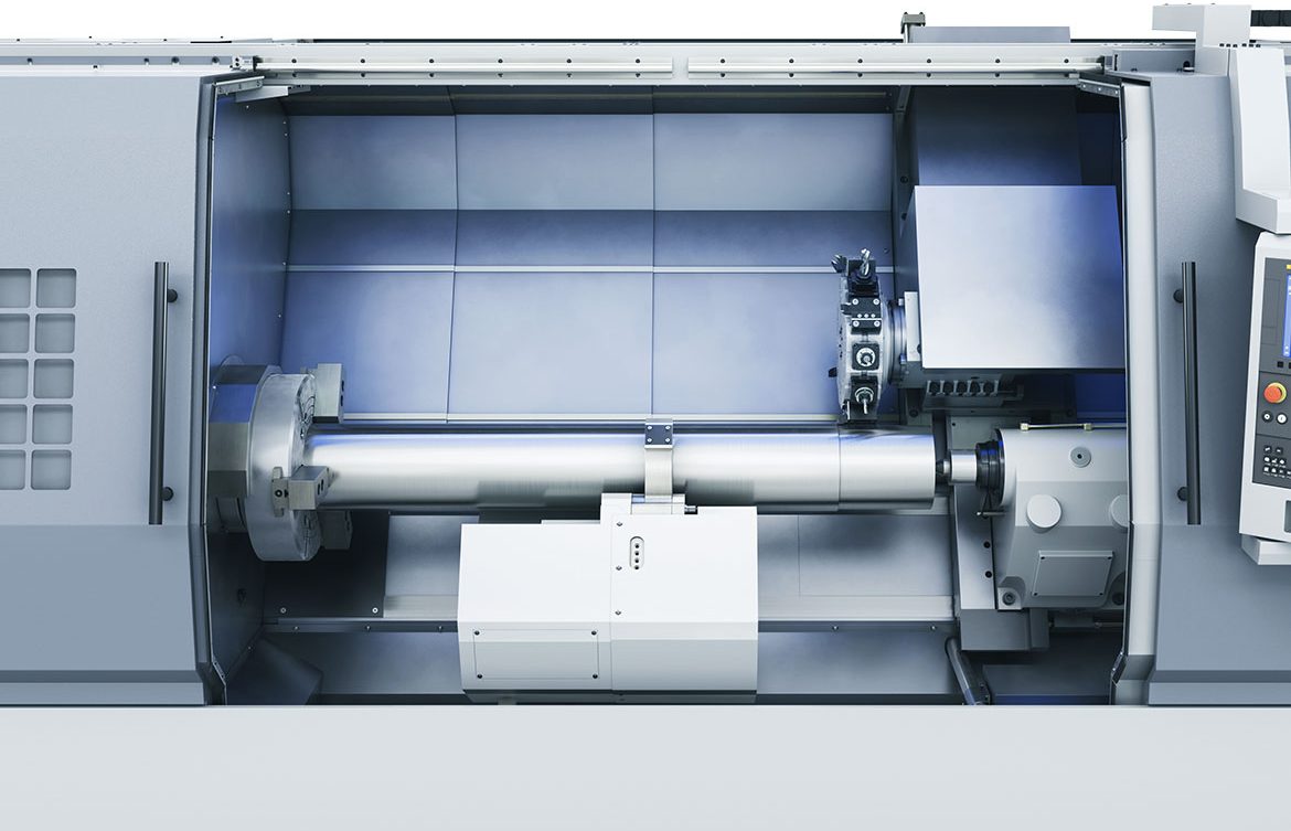

For workpieces, especially if they are long and relatively thin-walled, the machine must ensure stable support to avoid vibrations or deformation. The USC 850 is ideally equipped for this. Firstly, it has a robust hydraulic tailstock. This tailstock is used to support the free end of long workpieces. The quill has a diameter of 150 mm and a stroke of 150 mm. There is an MK6 centering cone in the quill, onto which a centering tip or a rotating center punch can be placed to center the workpiece end precisely.  The tailstock quill is positioned and clamped hydraulically and can be moved either via a CNC program or manually using a foot pedal. On the other hand, the machine can be equipped with a hydraulic steady rest, especially for very long or thin-walled workpieces. The steady rest is attached to the machine base and usually supports the workpiece in the middle or at a suitable point across the diameter. Our steady rests cover clamping ranges from Ø 30 mm to 245 mm.
Interior view of the work area of the USC 850 universal lathe.
Work area of the USC 850 with robust 60° inclined bed, BMT65 turret and hydraulic tailstock for large workpieces.

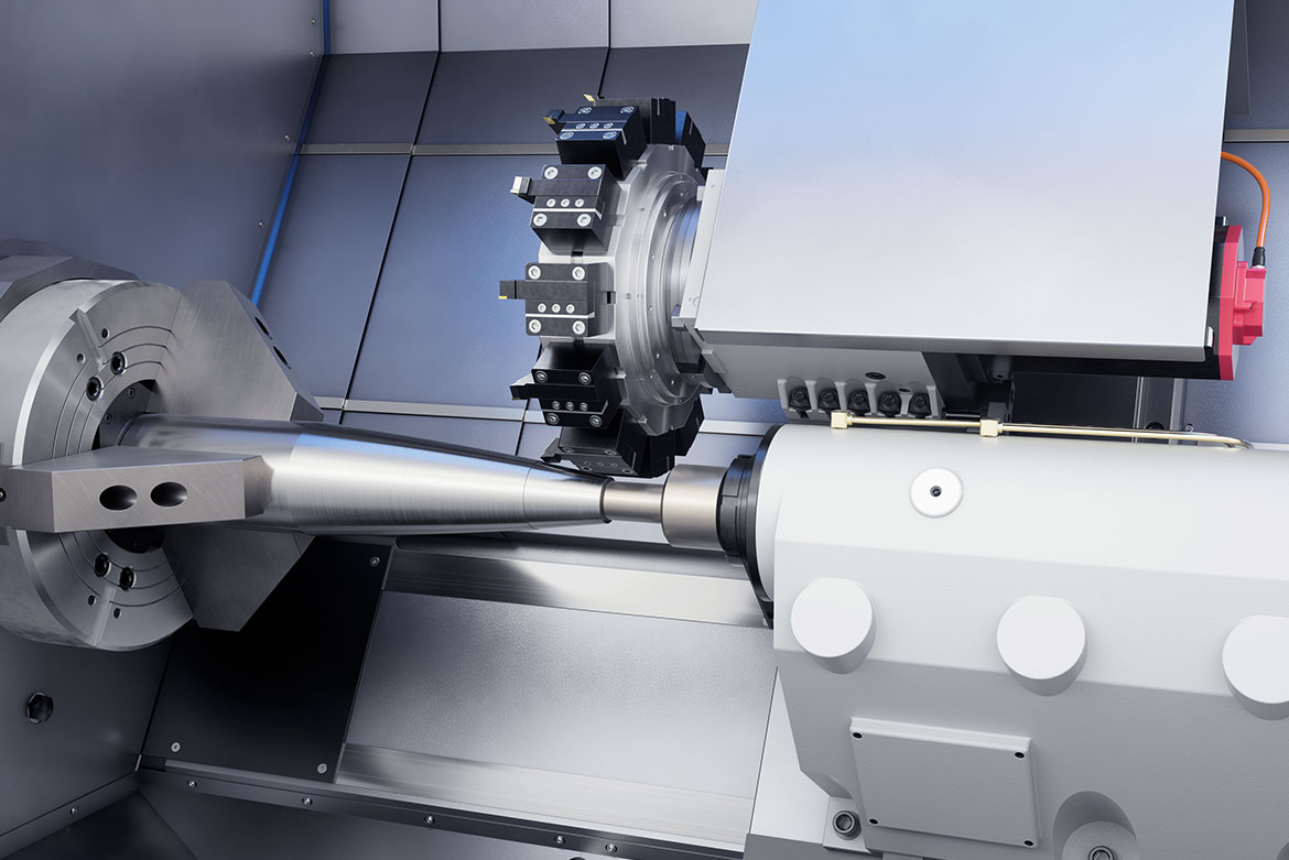

One workpiece that is currently in high demand is sleeves with a diameter of 155 mm. We have developed special processes and machining technologies for this, both for external and internal machining. A 155 mm artillery shell casing is typically a relatively long, cylindrical workpiece with a comparatively thin wall thickness. Without support, such a case could vibrate under the tool pressure or bend slightly, which would impair the dimensional accuracy. By using the tailstock in combination with the steady rests, however, the workpiece is held securely at both ends (and in the middle if necessary). Vibrations are suppressed and the shape remains stable. This allows us to turn, drill and, if necessary, mill with constant precision over the entire length of the sleeve without risking ovalities or wall thickness deviations, for example. Practical experience has shown that the USC 850 really comes into its own with such tasks: Long bullet sleeves or similar components can be finish machined with high precision in one or two setups. The hydraulic clamping forces of the steady rests can be sensitively adjusted and are digitally displayed so that the contact pressure is always under control – important for clamping the workpiece firmly without deforming it.
The USC 850 during the precision machining of a 155 mm artillery shell casing, optimally supported by a hydraulic tailstock.
Work area of the USC 850 universal lathe with a clamped 155 mm artillery shell sleeve, supported by a hydraulic tailstock, for vibration-free precision machining.
