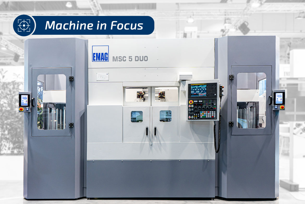

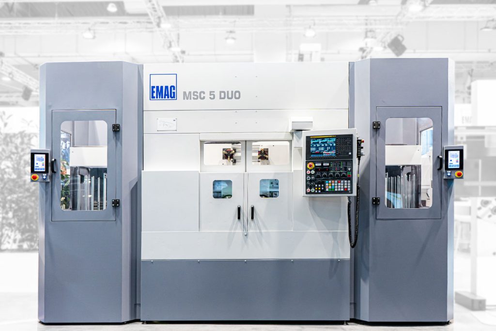

EMAG MSC 5 DUO CNC lathe in compact design with two machining stations and integrated automation.
The compact MSC 5 DUO manufacturing cell with integrated gantry handling and twin-gripper system. Two lateral storage units for raw and finished parts and FANUC control for fully automated operation.

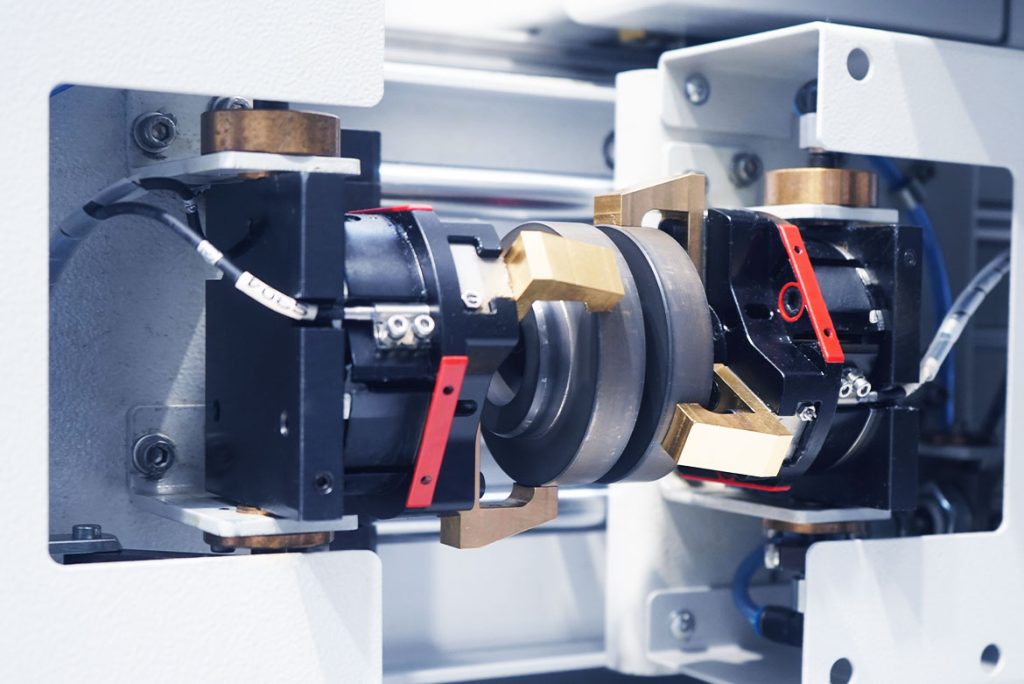

Automatic changing station of the MSC 5 DUO for changing the clamping position between the first and second setup without manual intervention.
The changing station enables a fully automatic clamping layer change. The twin-gripper sets down the workpiece, the clamping position is changed and the transfer to OP 20 takes place.

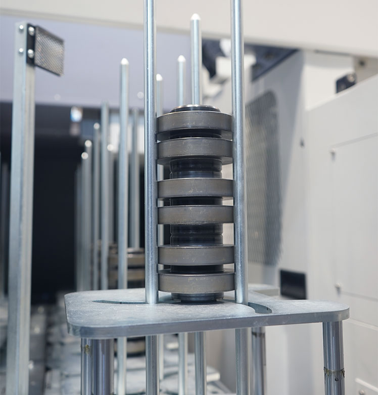

The stacker storage unit used has lift-out stations where the workpieces are positioned for pick-up or release by the gantry. For applications that require loading and unloading on the same side of the machine, the storage system can be equipped with a second lift-out station. This flexibility extends the machine’s range of applications in different production layouts.
Stacker storage of the MSC 5 DUO with stacked workpieces on lift-out station for automatic gantry workpiece removal.
The stacker storage unit with vertical workpiece arrangement and lift-out station for gantry removal. Two lift-out stations are optionally available to realize loading and unloading on the same machine side.

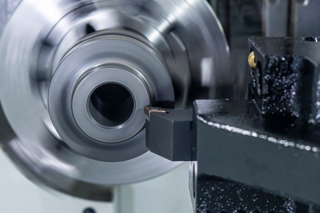

Turning of a rotating workpiece with turning tool in the CNC lathe MSC 5 DUO during the process.
Machining of a turned part in the MSC 5 DUO.

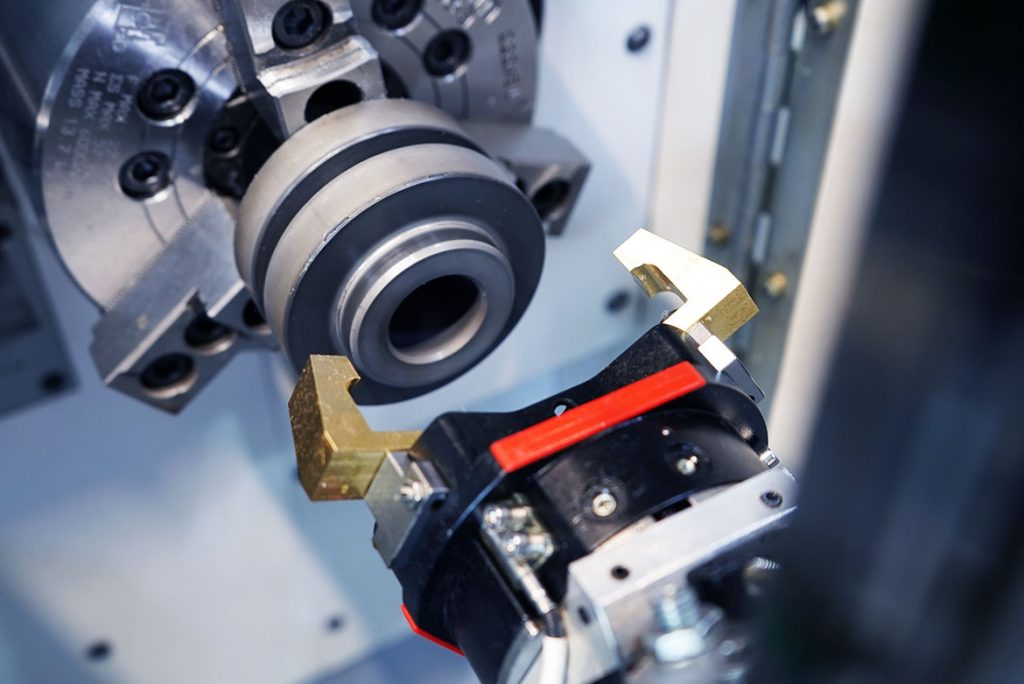

Twin-gripper of the MSC 5 DUO automatically inserting a workpiece into the chuck of the CNC lathe spindle.
The twin-gripper of the portal handling system inserts a workpiece with precision into the chuck of the machining spindle. Fully automated loading takes place without manual intervention during the process.
