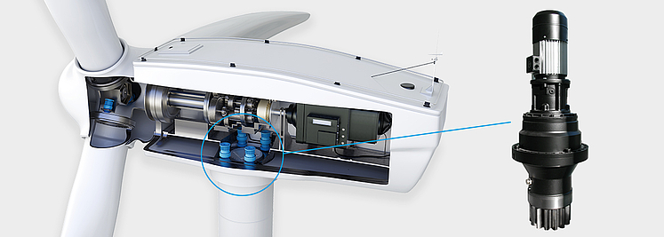

Wind turbines worldwide already generate more than 650,000 MW of power—and expansion keeps advancing, driven by policy commitments to reduce CO₂ emissions. EMAG’s CNC machines are ideal for producing drive housings, planetary carriers, and hollow gears used in azimuth drives for rotor blade alignment. The integrated technologies of turning, milling drilling enable cost-effective complete-machining of large components.
