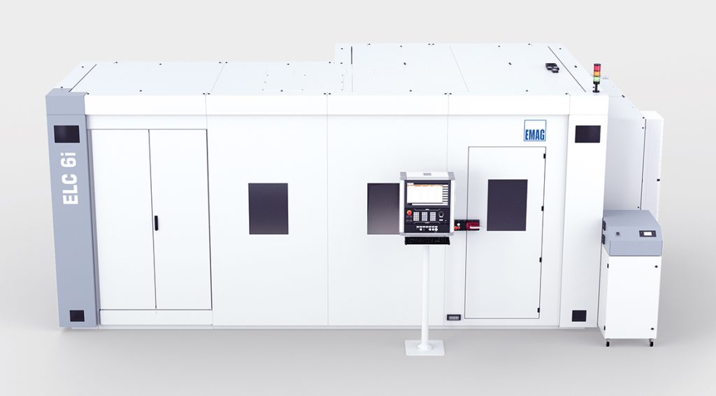

Front view of the ELC 6i laser welding system from EMAG with compact design and central control unit.
The ELC 6i is a standardized laser welding system for powertrain components. It integrates up to six process steps in one compact machine. The overall enclosure ensures laser safety and reduces the footprint.
What basic technical principles did you follow when designing the ELC 6i?
The central design principle was the integration of multiple processing steps in a uniform system with a continuous material flow. We deliberately decided against the concept of linked individual machines and instead developed a fixed cycle transport system that links all the process steps together.
The technical basis is a rotary indexing system with 14 to 18 workpiece holders, depending on the system configuration. The system rotates counter-clockwise and advances two positions at a time. This configuration enables parallel processing steps and minimizes non-productive times through optimized workpiece distribution. Even extensive process chains with up to six individual steps can be processed in less than 20 seconds cycle time.
The ELC 6i achieves a 36% space savings compared to conventional solutions. How did you technically realize such a compact design?
The space optimization is the result of several design measures. First, we integrated all process steps within a single, unified housing. This enclosure fulfills both the laser safety requirements for up to three laser processes and the role of a safety fence – eliminating the need for separate safety cabins for each individual operation.
With a footprint of 21.4 m², the ELC 6i requires significantly less space than conventional solutions. We have achieved this compactness without sacrificing any functions. On the contrary: all the necessary process steps are fully integrated. The continuous material flow also eliminates the need for intermediate buffers or complex transfer systems.

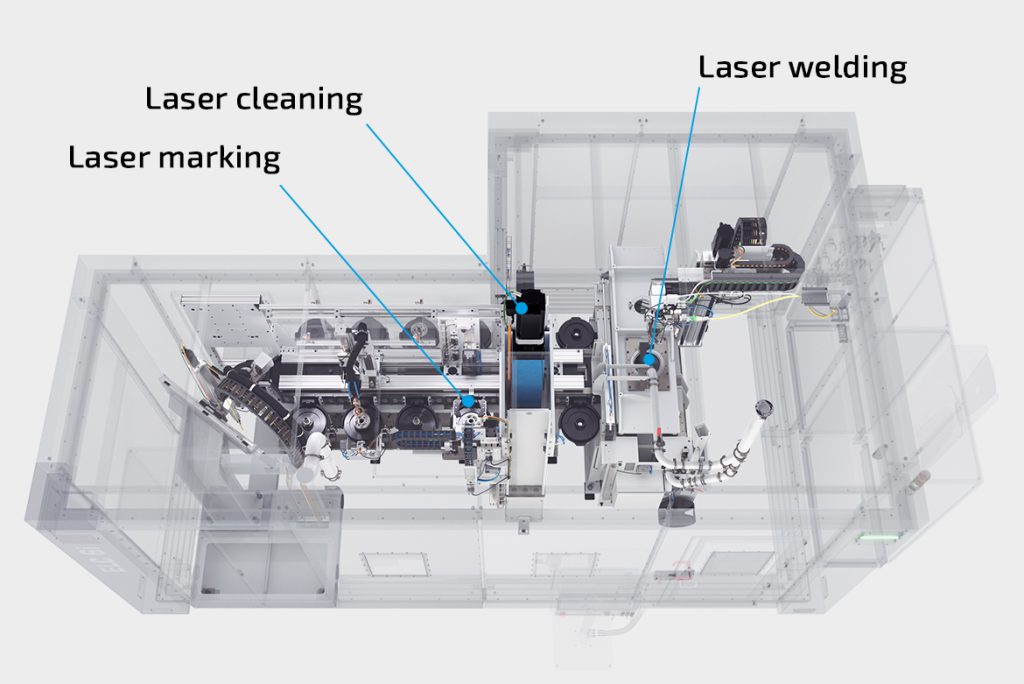

Interior view of the ELC 6i with marked laser processes: Cleaning, welding and marking in one compact system.
Schematic representation of the ELC 6i with integrated stations for laser cleaning, laser welding and laser marking. The compact overall enclosure replaces individual safety fence systems. All processes take place within a closed safety room.

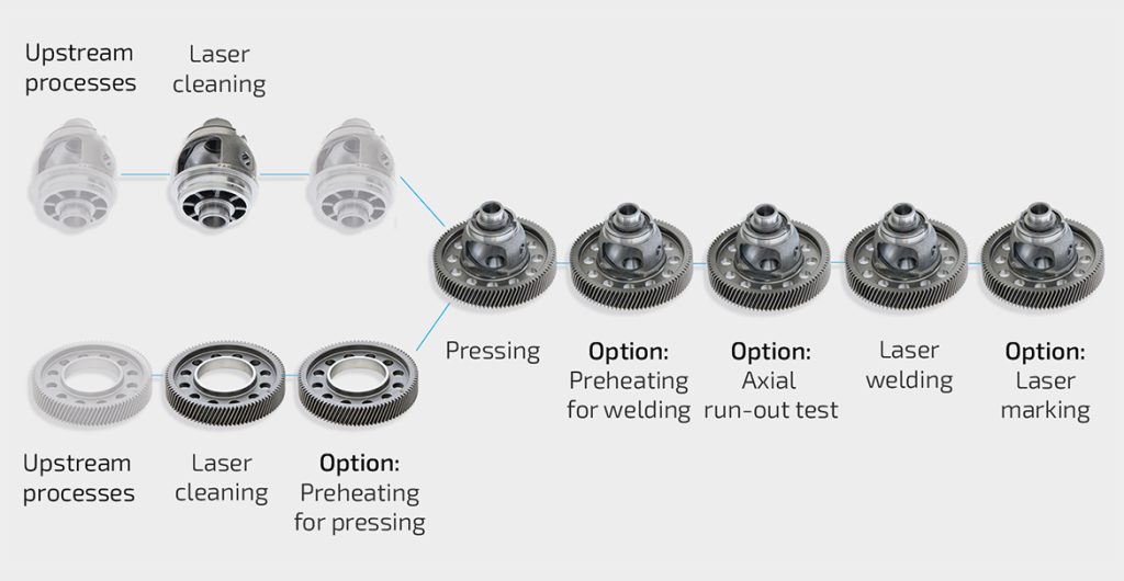

What exactly does the process sequence in the system look like?
The process chain begins with the placement of the two individual components – for example a differential housing and a spur gear. This is followed by laser cleaning of both joining surfaces. This is performed by a pendulum optic mounted on an X-Z-B kinematic system that oscillates between the two workpiece carriers. If necessary, an initial preheating process can follow to reduce the pressing force needed during joining. The components are then joined in a servo-mechanical unit. Optionally, a second preheating process follows, specifically in preparation for the welding process. In the next step, the weld seam is applied using a laser beam. Finally, the components can be laser-marked for component tracking and removed from the system.
Illustration of the process steps in the ELC 6i: laser cleaning, pressing, welding and optional testing and marking processes.
The illustration shows the complete process chain of the ELC 6i – from laser cleaning to joining and laser welding. Preheating and testing processes as well as laser marking for component identification can be integrated as an option. All steps are automated within the system.

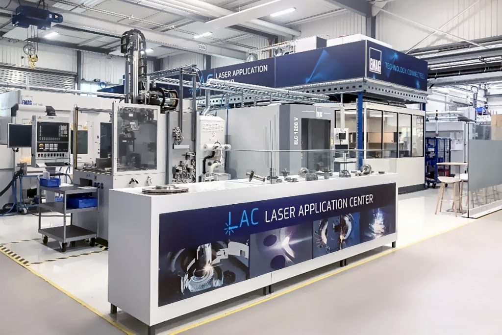

How does the Laser Application Center support customers in process development?
Our LAC in Heubach is a central component of our technology partnership. We have various laser beam welding systems with disk, fibre and diode lasers ranging from 200 watts to 24 kW. We also have laser cleaning systems, an ultrasonic testing system and extensive metallographic testing facilities.
Within this environment, we conduct feasibility studies, develop processes with customers, and, when needed, produce prototypes or small series. The special feature is that we use the same technology cells that are later used in the production systems. This ensures that all process results are directly transferable to series production.
View of the EMAG Laser Application Center with ELC system, test stations and development environment for laser processes.
In the EMAG Laser Application Center (LAC), laser welding processes are developed, tested and optimized together with the customer. Equipped with state-of-the-art technology, the LAC supports process design, prototype manufacture and series preparation.

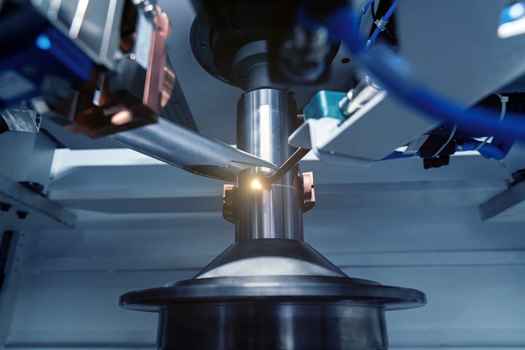

The ELC 6i is highly adaptable thanks to its modular concept. Rotor shafts for electric motors, for example, are already a typical application. The basic process steps – cleaning, heating, joining, welding – remain relevant even with new drive technologies.
Rotor shaft during laser welding in the ELC 6i - controlled process for precision weld seams on rotationally symmetrical components.
Laser welding process of a rotor shaft in the ELC 6i: Precision laser guidance and a stable process sequence ensure reproducible seam quality with minimal component distortion.
