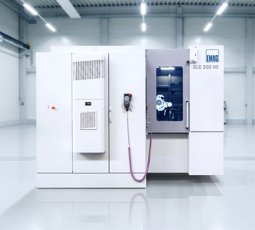

CLC 200 HC vertical gear hobbing machine with integrated chamfering station. Suitable for precision gear hobbing up to module 5.
Exterior view of the CLC 200 HC vertical gear hobbing machine with integrated chamfer-cut station.

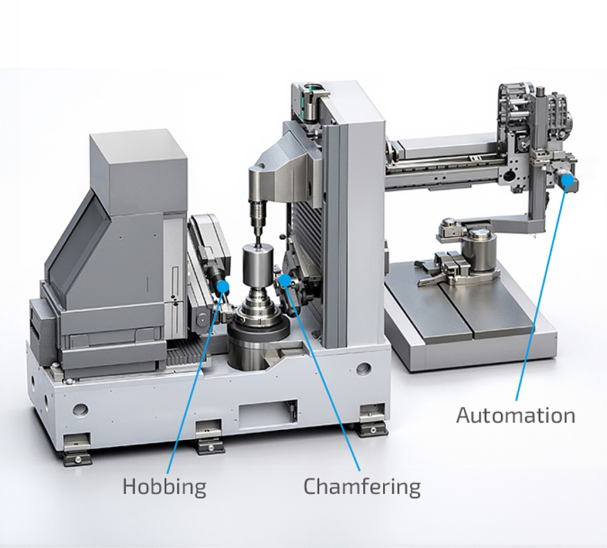

Schematic representation of the CLC 200 HC with integrated gear hobbing and chamfer-cut station. The configuration shows the stationary workpiece table, the direct-drive gear hobbing head, and the chamfering unit in a single setup.

A key feature of the CLC 200 HC is the integration of the chamfering and deburring process directly into the gear hobbing process. Gear hobbing takes place on one side of the setup, while deburring and chamfering are performed on the opposite side. Both processes utilize the same workpiece clamping setup, eliminating the need for phasing entirely.
The first pass begins with the gear cutting. At the same time, deburring takes place on the underside of the workpiece. After the hob is retracted, the upper gear teeth are chamfered. This is followed by the second hobbing pass, while the chamfering is completed cycle time-concurrently with the main machining time.

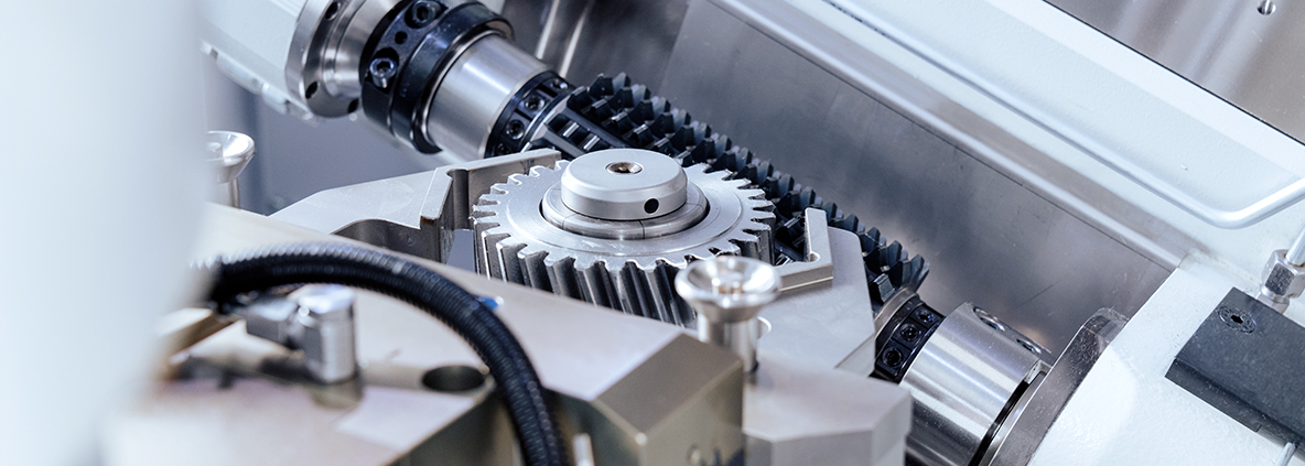

Hob milling of external gear teeth on the CLC 200 HC. Direct drives and rigid setup ensure high gear tooth quality.
Close-up view of the gear hobbing process on the CLC 200 HC with a stationary workpiece table and a direct-drive gear hobbing head.
