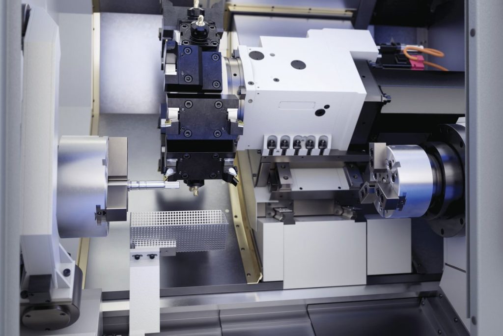

HSC 1 lathe with counter spindle for machining the front and rear sides in one process sequence
Work area of the HSC 1 with main and counter spindles. The workpiece transfer between the spindles enables continuous OP 10 / OP 20 production.

HSC 1 lathe with Y-axis and C-axes for flexible CNC machining.
Design of the HSC 1 with three linear axes (X, Y, Z) and one C-axis each on the main and counter spindles. The Y-axis with ±50 mm travel extends the machining spectrum to include off-center milling and drilling operations.

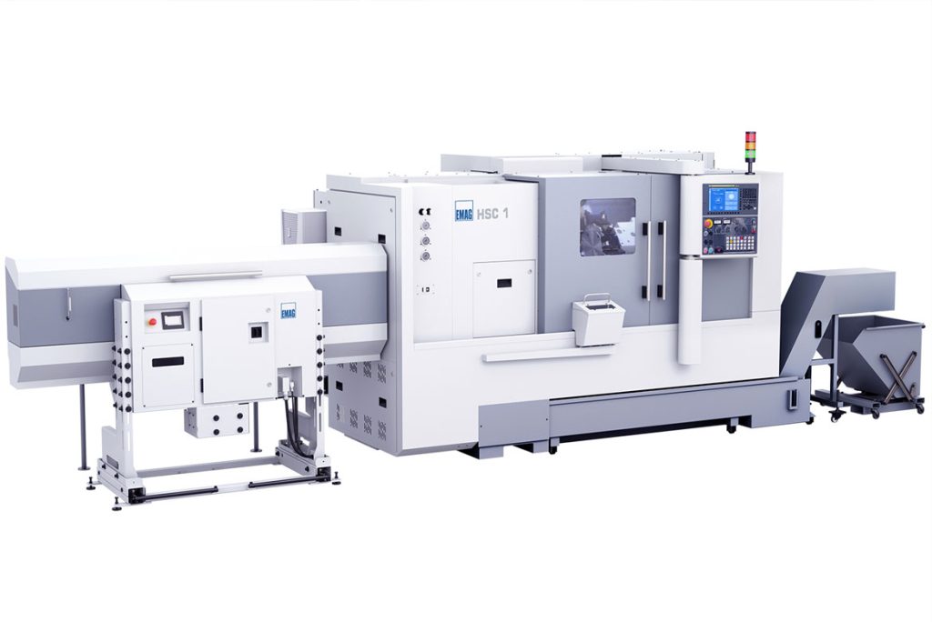

View of the HSC 1 with connected bar feeder for automated material feed and integrated chip conveyor.
HSC 1 lathe with bar loader and chip conveyor for automated machining.
