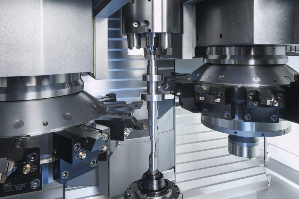

David: It really boils down to this: The VT 4 does what most machines can’t – all in one setup. It’s got two turrets with live tooling and simultaneous 4-axis machining, so you’re cutting from both sides at once. You can turn, drill, mill, even brush – all in the same machine. Normally you’d need a second machine just for those extra ops. Not here. That consolidation is a big win.
VT 4 dual turrets with eleven tool posts each for simultaneous four-axis machining.
Interior view of the VT 4 showing two tool turrets, each equipped with eleven tool posts (one post per turret used by the gripper). This configuration enable simultaneous machining from both sides for faster cycle times and reduced setups.
Q: So it’s not just about turning. It’s doing secondary operations, too?
David: Exactly. Let’s say you’ve got to mill a slot then drill and brush to deburr the slot. With most machines, you’re handling it off to a second op – extra time, extra tooling, more space. With the VT 4, it’s one and done. The live tooling makes it super versatile.

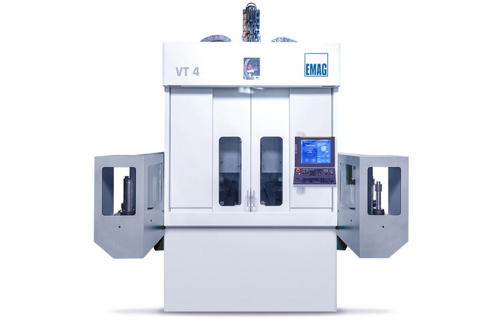

Full exterior view of the EMAG VT 4 vertical turning machine.
A full exterior view of the EMAG VT 4 vertical turning machine, showcasing its space-saving design and robust enclosure – ideal for automated, high-precision shaft production.

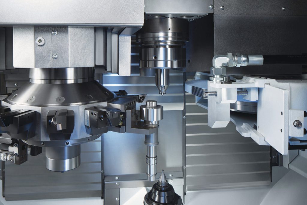

VT 4 workpiece grippers loading and unloading parts automatically inside the machine.
Close-up of the VT 4’s integrated workpiece grippers transferring raw parts into and out of the machining area. The built-in automation reduces handling time, increases throughput and eliminates the need for external loading systems.
