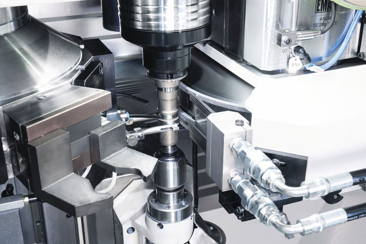

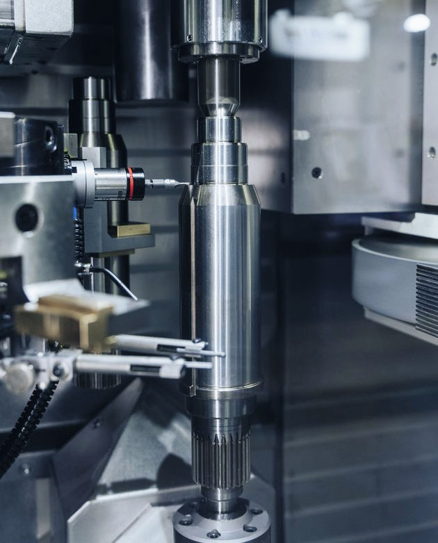

A very good example is the machining of rotor shafts. These are the heart of the electric drive and place high demands on the machining process.  Bearing and sealing ring seats, the rotor, ring grooves and face shoulders are machined in a single setup. A grinding process is often prescribed for the hard machining of the bearing seats. This is pre-turned to achieve a constant grinding allowance. The adjacent face shoulders do not require a grinding process, but are turned.  The sealing ring seat is also pre-turned and then ground. A swirl-free Rz of 1–3 µm is often required here. The rotor is also turned first and then ground. The required drawing tolerances are IT6. Compliance with the tolerances can be ensured using the in-process measuring head.
The vertical work area of the VTC 100 GT enables the complete-machining of e-rotor shafts.
Vertical work area of the VTC 100 GT with clamped E-rotor shaft. The vertical arrangement enables optimum chip fall. The picture shows the measuring head for probing the axial position of the rotor shaft and the in-process measuring head.

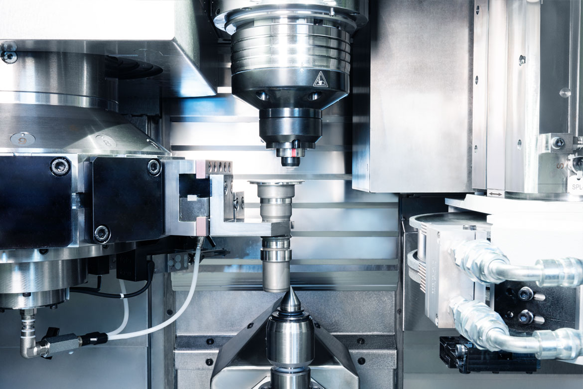

The following is a completely different example: Joint housings are to be turned and ground. The machining requirements are similar to those presented for the rotor shaft.
The annual quantity of 500,000 workpieces requires a rethink.  Machining processes must be completed in parallel. This was solved with a VT 100 as a pure turning machine, which was connected to a VTC 100 GT via Track Motion. The turret of the VTC 100 GT was equipped with two grippers for this purpose. This enables a quick change between raw and finished parts in the machine.
Joint housing on the VTC 100 GT.
Joint housing on the VTC 100 GT: The machine achieves a cycle time of 36 seconds with two grinding operations, one of which is twist-free. A coaxiality of the two seats of ≤ 0.005 mm with a center roughness value of Ra 0.2 – 0.6 µm.

Detailed view of the turret during the loading process.
The turret of the VTC 100 GT performs the loading and unloading function as well as the tool receptor. The gripper system transports the workpieces between the integrated storage and the working position, eliminating the need for additional handling systems.

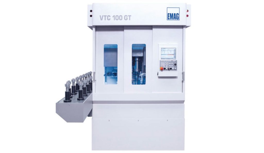

A big advantage of the VTC 100 GT is its small footprint. Despite its extensive functionality and integrated workpiece storage, the VTC 100 GT has a very compact design.  Connections to additional automation is trouble-free.
Frontal exterior view of the VTC 100 GT.
The VTC 100 GT combines grinding, hard turning and skiving in one compact unit. The vertical design and integrated storage systems minimize the footprint in production, while providing optimum accessibility for set-up processes.
