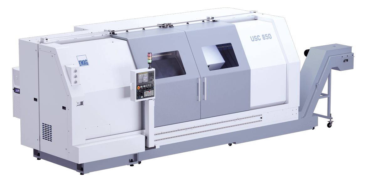

Mr. Scheschy, the EMAG USC 850 has been announced as a new CNC universal turning machine. What characterizes this machine and for which areas of application was it developed?
The USC 850 is a universal lathe that has been specially developed for the precision and efficient machining of large turned parts. We are talking about a machine that impresses with its robust design, state-of-the-art CNC control technology and excellent machining accuracy. In concrete terms, this means that with a maximum turning diameter of 700 mm and a turning length of 2,000 mm, the USC 850 offers exceptional machining flexibility. Even workpieces weighing up to 600 kg can be securely clamped and machined with the help of the tailstock. The machine meets the highest requirements for dimensional accuracy and surface quality. It was developed primarily for users in demanding industries: automotive suppliers, aerospace or general mechanical engineering – wherever large rotationally symmetrical precision parts need to be produced economically. In short: The USC 850 combines high precision and productivity when machining large workpieces.
Exterior view of the USC 850, equipped with modern CNC control.
Exterior view of the USC 850 universal lathe with closed housing, CNC control panel and stable machine structure for demanding machining tasks.

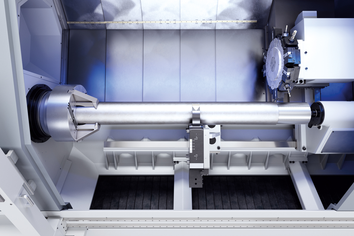

Large and long workpieces place special demands on clamping and stability during machining. What features does the USC 850 offer for precision machining of very long or thin-walled workpieces?
For workpieces, especially if they are long and relatively thin‑walled, the machine must ensure stable support to avoid vibrations or deformation. The USC 850 is ideally equipped for this. Firstly, it has a robust hydraulic tailstock. This tailstock is used to support the free end of long workpieces. The quill has a diameter of 150 mm and a stroke of 200 mm. Inside the quill there is an MK5 centering cone, into which a live center can be inserted to precisely center the workpiece end. The tailstock quill is positioned and clamped hydraulically and can be moved either via a CNC program or manually using a foot pedal.
Secondly, the machine can be equipped with a hydraulic steady rest, especially for very long or thin‑walled workpieces. The steady rest is mounted on a slide and usually supports the workpiece in the middle or at another suitable point across the diameter. Our steady rests cover clamping ranges from Ø 30 mm to 245 mm, or alternatively from Ø 45 mm to 310 mm.

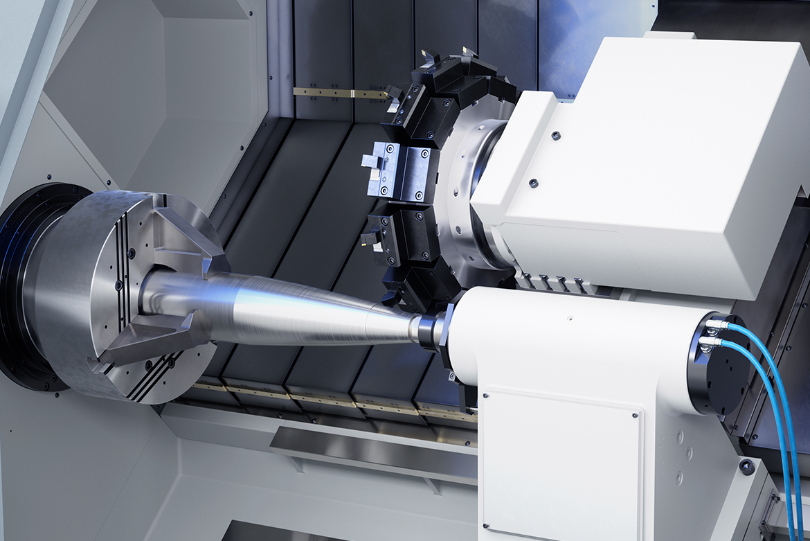

Can you give us an example of a typical workpiece for which the USC 850 is particularly well suited?
One workpiece that is currently in high demand is sleeves with a diameter of 155 mm. We have developed special processes and machining technologies for this, both for external and internal machining. A 155 mm artillery shell casing is typically a relatively long, cylindrical workpiece with a comparatively thin wall thickness. Without support, such a case could vibrate under tool pressure or bend slightly, which would impair dimensional accuracy. By using the tailstock in combination with the steady rest, however, the workpiece is held securely at both ends (and in the middle if necessary). Vibrations are suppressed and the shape remains stable. This allows us to turn, drill and, if necessary, mill with constant precision over the entire length of the sleeve without risking ovalities or wall thickness deviations.
Practical experience has shown that the USC 850 really comes into its own with such tasks: long shell casings or similar components can be finish‑machined with high precision in one or two setups. The hydraulic clamping forces of the steady rest can be sensitively adjusted so that the contact pressure is always under control – important for clamping the workpiece firmly without deforming it.
The USC 850 during the precision machining of a 155 mm artillery shell casing, optimally supported by a hydraulic tailstock.
Work area of the USC 850 universal lathe with a clamped 155 mm artillery shell sleeve, supported by a hydraulic tailstock, for vibration-free precision machining.
