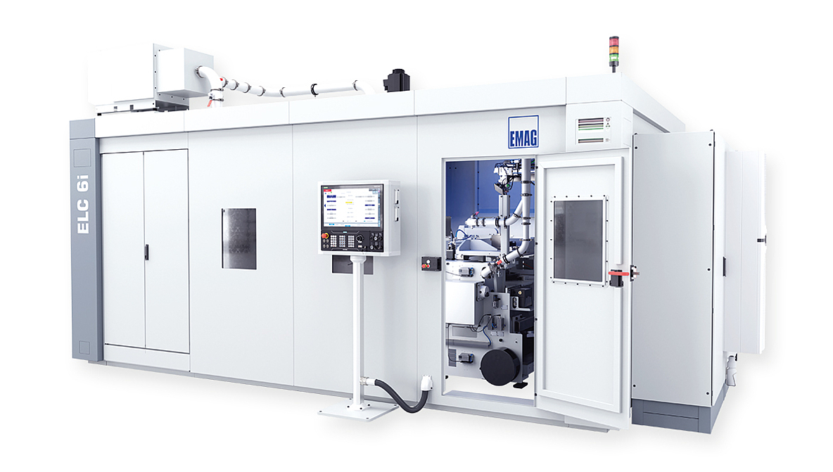

ELC 6i - Compact standard solution for industrial laser welding
The EMAG ELC 6i is a fully automated laser welding system that integrates up to six process steps in a single machine. Its standardized concept minimizes engineering effort, reduces investment costs and shortens delivery times – all without compromising on precision and process quality.
Key features at a glance:
  • Process integration: laser cleaning, preheating 1 (option), joining, preheating 2 (option), laser welding, marking (option)

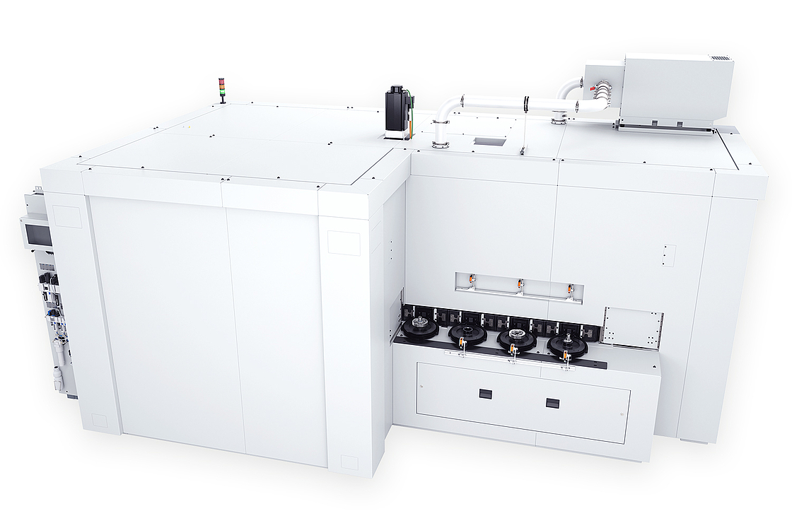

  • Compact design: only approx. 21.5 m² footprint, up to 36% less space required than conventional lines
  • High productivity: cycle times under 20 seconds with a fixed transfer system and up to 18 workpiece carriers
  • Process reliability: proven multi-axis kinematics for high-precision welding processes
  • Cost-efficiency: up to 15% lower investment costs and up to 10% shorter delivery times.

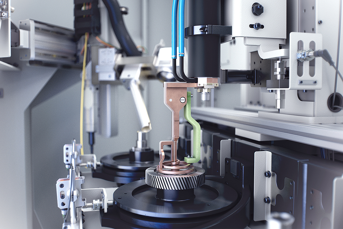

The ELC 6i delivers a fully integrated process chain, with each step automated and seamlessly connected within the system:
  1. Loading and unloading - two stations for raw-part placement and two stations for removing the finished assemblies.

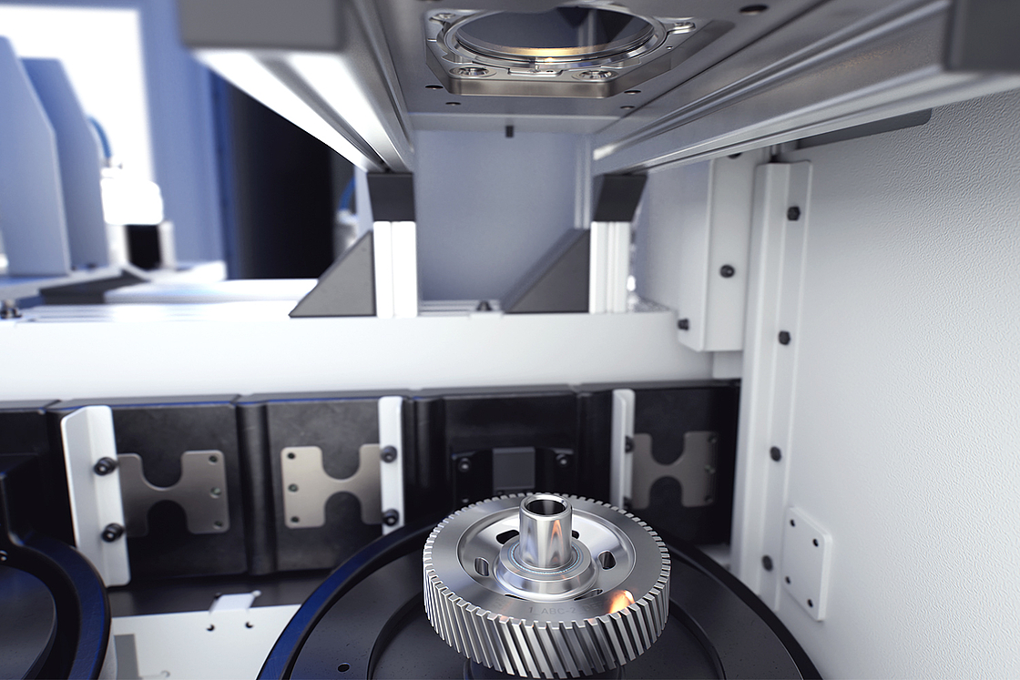

  2. Laser cleaning - precise removal of impurities and coatings on the joining surfaces.
  3. Inductive preheating 1 (optional) - reduces pressing forces and improves weld seam quality.

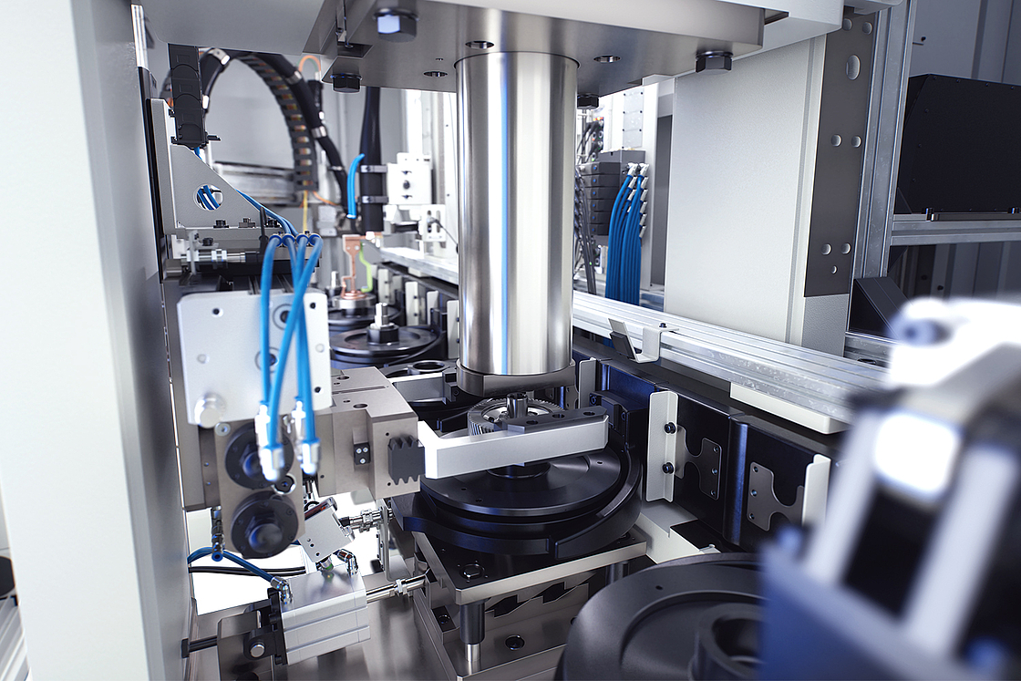

  4. Joining (pressing) - force-displacement-monitored pressing process using a servomechanical unit.
  5. Inductive preheating 2 (optional) - improves weld seam quality with challenging materials and / or component geometries

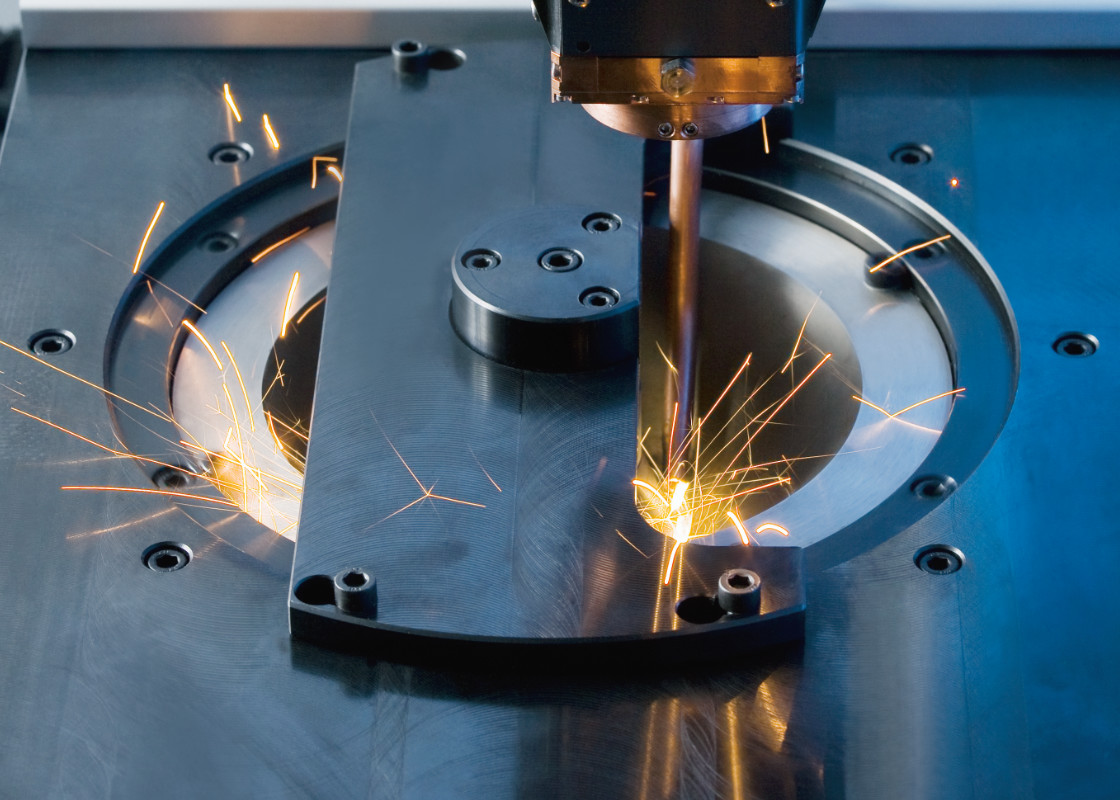

  6. Laser welding - high-precision circumferential welding with optional wire feed and seam position control.
  7. Marking (optional) - component marking by laser or needle marking for traceability
ELC 6i laser welding - Integrated process chain with laser cleaning, preheating, pressing, welding and marking for powertrain components

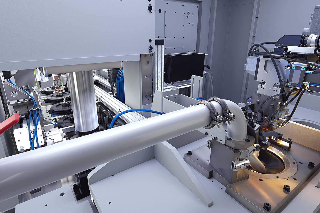

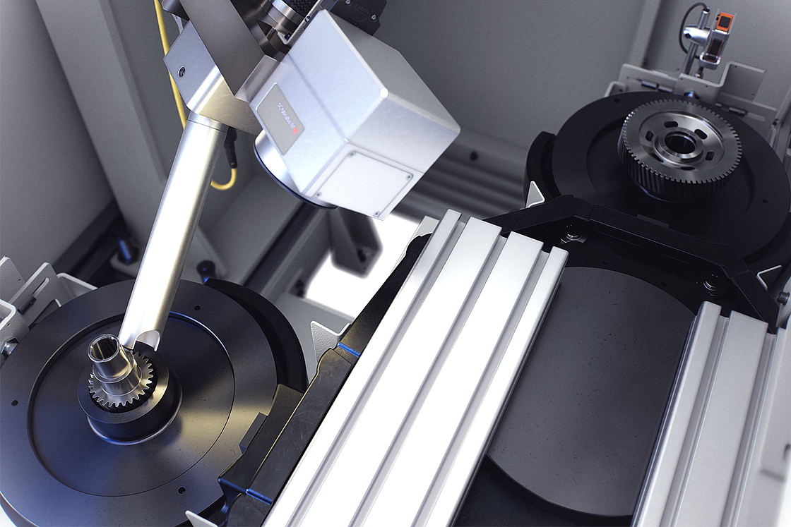

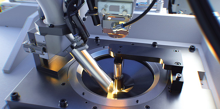

Working area of the ELC 6i: integrated stations for laser welding, laser cleaning and laser marking
