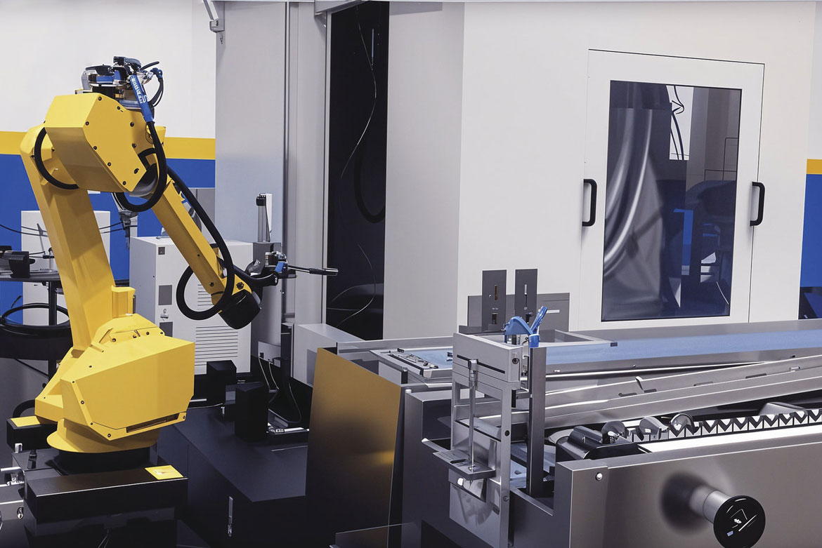

Yes, in addition to the ring loader, we also offer robot loading. A 6-axis robot stands behind the machine and loads directly onto the spindle. The CLC 200 is equipped with an automatic sliding door for this purpose. Although the robot takes a little longer than the ring loader for a complete loading cycle, it is more flexible. For example, it can deburr or clean workpieces in a deburring or cleaning station or inspect them in a measuring station. This is the advantage of the robot, it can also take on other tasks in addition to loading and unloading. For customers with complex workpieces, long running times or frequently changing part families, the robot solution may be the better choice. It always depends on the individual case. The service door can also be opened automatically as an option.
Robot loading at the rear of the CLC 200 gear hobbing machine through a loading door for increased production efficiency.
A robot is positioned at the rear of the CLC 200 gear hobbing machine, which loads a workpiece into the machine through an open loading door. This configuration enables efficient and fast production, as the robot can prepare other workpieces in parallel with machining.
