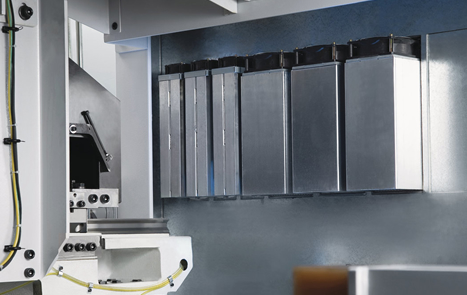

All amplifiers are representative of the new through-hole technology (other options are available). This ensures that their waste heat is expelled into the workshop and the cabinet no longer has to be air-conditioned. This allows for the cooling units to be reduced in size, making them more effective.

Energy-saving through-hole principle
On the VL 5i, VSC 250 and VLC 250 EMAG make use of the possibility to push amplifiers through the back of the electrical cabinet and to cool them down with a simple fan that expels their waste heat into the workshop. Energy-guzzling heat exchangers can thus be dispensed with.
