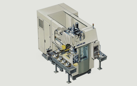

The innovation: The vertical pick-up turning machine
In 1992, EMAG was the first manufacturer to build a vertical pick-up turning machine. The machines combine loading / unloading (automation), machining and measuring.
The result: Automatic loading of the EMAG vertical turning machines ensures that unproductive times are much lower than those generated on horizontal turning machines.
The result: Fewer machines are needed to do the same amount of work.
Sustainability: Durability and high productivity rates reduce the energy requirement per workpiece.

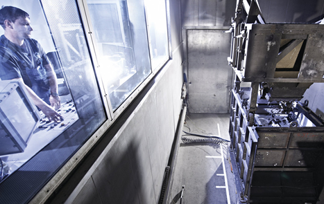

Foundry – but a totally different one. Here is where the machine bases in high-quality polymer granite are cast. Filling of the casting moulds is computer-controlled and usually carried out during the evening shift. As early as the following day, the bases are machined (just 1 milling operation), primed, varnished and sent off to the assembly line.

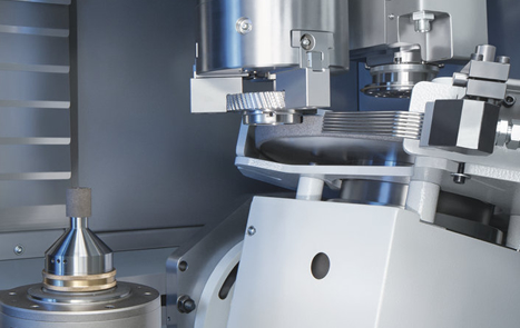

The innovation: multi-functionality
EMAG offers multi-functional machine tools that combine a number of processes on a single machine: turning, drilling, milling, grinding, gear cutting, etc., allowing for different processes to be used in the machining of the component.
The result: The same basic machine is used for the application of different machining processes. This increases flexibility and allows for a variety of workpieces to be processed on the same machine.
Sustainability: Increased use of the machine. The same basic machine can be used for the application of different processes. Therefore, a reduction in the number of machines used leads to a reduction in the energy required to manufacture the machines and a reduction in the energy required to machine the workpieces.

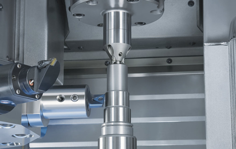

The innovation: “Scroll-free turning” technology
The principle of “scroll-free turning”, developed by EMAG, is very different then any traditional turning work. During the scroll-free turning process the tool carries out a rolling motion on the workpiece, i.e. a diagonally positioned CBN cutting edge moves over a rotating workpiece. The cutting speed is governed by the workpiece rotation. The overlaying motions of tool and workpiece ensure that the cutting action point advances constantly. This is not only ideal for the cutting edge; it also makes for a totally different load distribution than in the traditional turning process. The passive forces load is noticeably higher. Scroll-free turning is a very fast process – about 5 to 6 times the speed of previously used hard-turning operations and 2 to 3 times the speed of grinding. It also offers exceptional surface finishes, without any scroll marks. In other words, surfaces that previously had to be ground can now be scroll-free turned.
The result: Much faster machining of the workpieces. No surface finishing operation needed (exceptional surface finish, without scroll marks).
Sustainability: The energy requirement per machined workpiece is significantly lower. Dry machining processes require no coolant.

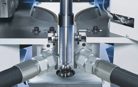

The innovation: “Synchronous support grinding” technology
The synchronous support grinding process combines, for the first time, flexibility and high productivity rates in the grinding of shaft-type components – with a noticeable grinding time reduction of up to 70% compared to conventional grinding processes. Two opposed CBN grinding wheels machine the same sector on the workpiece.
The result: Much faster machining of the workpiece. Outstanding surface finishes. Very high feed rates can be used.
Sustainability: A very fast process: the energy requirement per machined workpiece is significantly reduced. Also reduced are the unproductive times.
